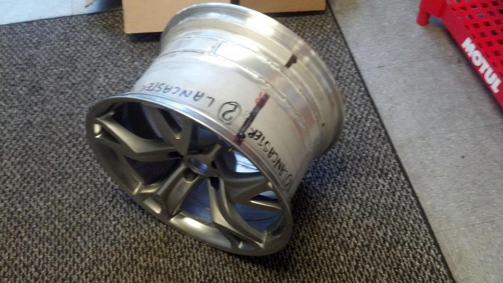

Question: What are my offests!?!
I think my calculations are off... this is what I posted on my350z.
I think when i added two inches to the inside, I only need to calculate moving the center over ONE inch not two????!?!??!?!
So I believe after more thought that the wheel specs on the rear are:
Stock is +30, adding 2 inches or 25.4 x 2 = 58.4mm to the inside. That moves the Center over 25.4 inches making the higher offset of 50.5 from the center to outter edge...then leaves 60.8 to the inside..I added a 20mm spacer to increase the rim hub thickness to (stock 30 + 20mm) is 50mm from the mounting surface of the rim to the outer edge. The remaining portion (mounting surgace to inside is 60.8?? I guess LMFAO. Took two years now Im ready to sell these and work up a set of GTR 20s, any trades or buyers. lol?
confused...but it works..lol
Originally Posted by Me on My350z
I started with 6 stock rear 370z 19s (19x10 on all fours)
I sent two off to Weldcraft for a 2 inch addition. tested the 275 and 305 on the fronts
Stock i think is +30, adding 2 inches or 25.4 x 2 = 58.4mm to the inside.
higher offset
So I guess that makes it a +88.4
Then I added a 25mm spacers, pulling it out.
lower offest
making it a +63.4-ish???????
19X10F +30 305/30/19
19x12R + 63 ish 345/35/19
higher offset
lower offest
