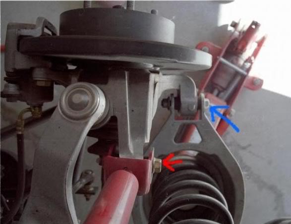

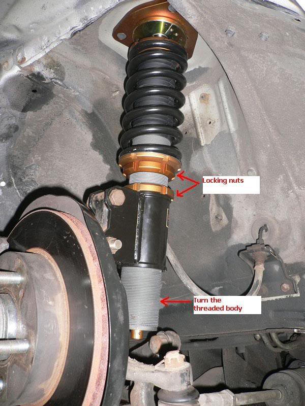

Yes but not running coil overs. the coil over at times will take 10-15mm from the inside. I am running a 19x12 but no coil over so there is space to run an 11 with a small spacer if you run the coil....how much? thats TBD!!
If there was just the strut look how much more room you can play with. Im being generous by saying 1.5 inches but im close. I use the 10-15mm for good meausure the rear in shakes around a but especially if your boosting of driving hard, who knows the actual travel distance of the suspension under load and stress.
