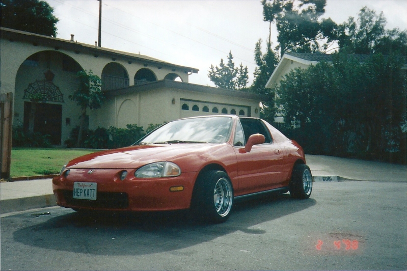

I want to put 19x12 and 19x11 +7 offset all the way around. I'm at stock height what work will have tobe done? Pull or roll?
Old May 5, 2014 | 09:11 PM
  #6990
BowWizzel's Avatar
Joined: Apr 2012
Posts: 1,087
Likes: 96
From: San Jose
Stock height, don't even think about an aggressive setup like that unless you want to look like this V
