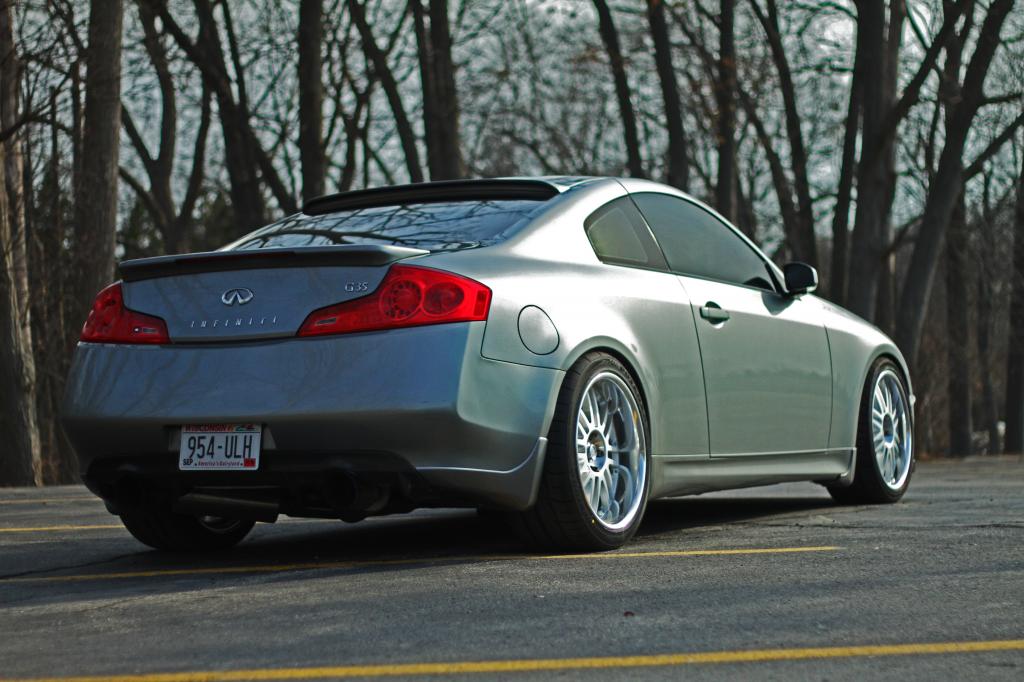

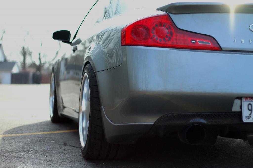

Im looking to buy some STR wheels for my G35. Im going to go with 19x8.5 in the front and 19x10 in the rear. I want a flush look so need help with the offset. can you guys post pics of the wheel offset you guys are running?
Old Oct 30, 2014 | 03:54 AM
  #7140
scottvt's Avatar
Joined: Sep 2012
Posts: 252
Likes: 27
From: Wisconsin
EDIT since this thread got moved: In reply to ILoveMyG35&DC5....
I'm running 19x9" +26 in the front and 19x10.5" +22 in the rear with 16 mm spacers all around.
I haven't had an alignment yet, so I can't tell you my camber specs. If you are set on those widths, I would say +4 in the front, and 0 offset in the rear with no spacers at all SHOULD get you roughly where I am at as far as "flush" whether or not this is what your going for, or the Hellaflush look. I am no wheel expert, but it's math, so I think I am pretty damn close.
