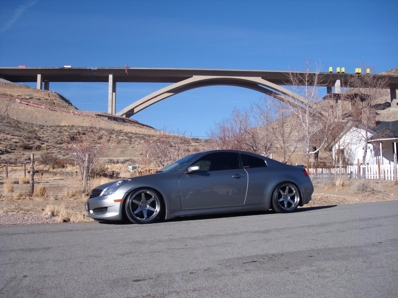

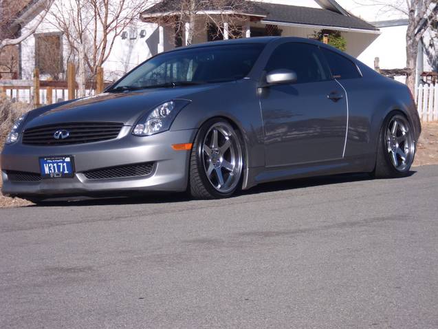

Chatt and me and a couple others have contributed more to this thread than any.... so as far as non topic hecklin comments, they will be reported and not responded too..
have a great day.. even the haters..
Attached Thumbnails Varrstoen (te reps) in +22 or +12 with tein s techs for g35 coupe?-024.jpg   Varrstoen (te reps) in +22 or +12 with tein s techs for g35 coupe?-004.jpg   Varrstoen (te reps) in +22 or +12 with tein s techs for g35 coupe?-tn-er.jpg   Varrstoen (te reps) in +22 or +12 with tein s techs for g35 coupe?-securedownload-b.jpg

looking good and low Jentz! the polished looks great!
and to Ambiguous i think polished would look great on your coupe..alot of people are doing white now but it takes the right car to pull off white wheels..The color of your car doesnt give me many ideas as to what would flow well with it..maybe you can do like an Anthracite powder coat or a bronzish/gold color .i was thinking about redoing my wheels also but having the same issue with color choice...i was thinking a Mag Blue type color..but im enjoying the matte black for now..
