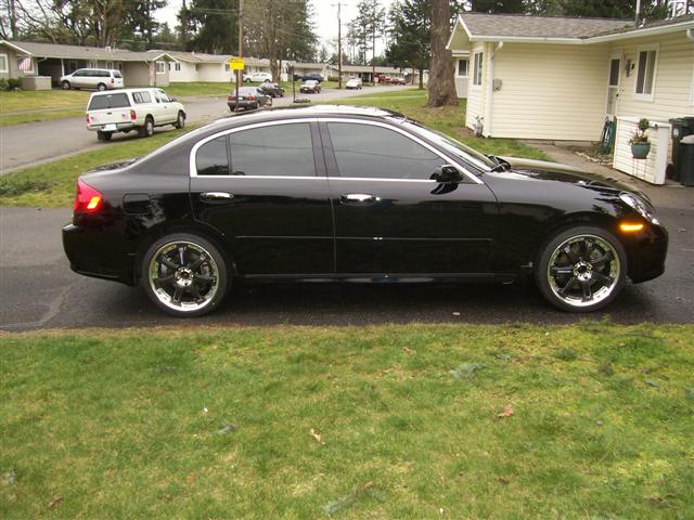

Ok here is a pic of my wheels.
+46 are kind of close to the control arm...but Im going put in some 5mm spacers to fix that problem. But they are not rubbing.
The stock wheels are +45 so It wasn't too much of a difference.
