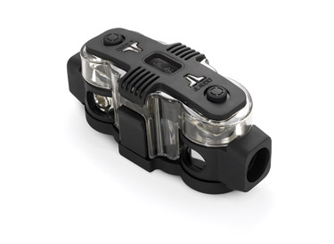

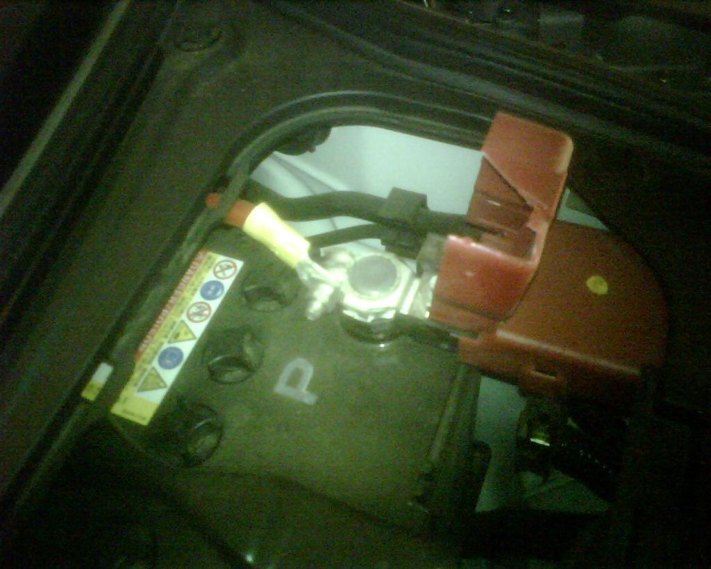

Ok this is going to be a stupid question. I ordered everything you ordered, same amp kit aswell. I just cannot figure out how to connect the power wire to the battery. Its a big fuse block with an open end for a wire? lol how do I get this all to work?

Here's a pic of how to attach it. Sorry, it's from my Blackberry. You need an end that you can screw onto the battery terminal. I think one of the guys at Best Buy gave it to me. I'm sure you can find it at Radio Shack or any stereo store. Good luck!

Ok so I have this connection below. One end is going to the amp, while the other end is open, no wire. So I gotta find another 4 gauage wire? then attach a round batter connector to that?
Yes thats your fuse block. Just cut a length of your wire coming from your amp and use that, you should have plenty left over.
