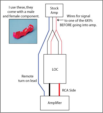

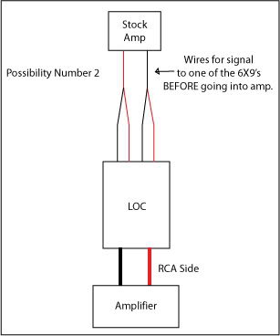

Jesus, I think I'm going to have to draw a diagram for you cause explaining it might be too difficult. Bottom line, I'm only getting the signal from ONE 6X9, not from both.
Alright, here's my diagram for ya.
I'm not sure exactly how mine is wired, and it would be a big PITA to go check so, I drew two diagrams... I know that I have ONE of the two on mine, and it works... I had to fubar with it a lot before it worked.
And the other one:

hey I have the whole car wired from battery to trunk etc etc, got the amp grounded n wired only thing is im not getting ANY bass from the sub. the 6x9 work fine and i did the whole stripping wires according to color (purple pink teal grey etc etc.) I pluged in the fuse in the battery and then hooked up the RCA plugs turned on the car and the amp lights up and seems to flicker with the thump of the subs (6x9) im guessing that normal? however the actual subwoofer is not even budging...any idea?

I don't know anything specifically about that LOC but, did you read my posts directly above yours?? I had a problem very similar to yours and thought I had everything wired correctly but for some reason it required some interesting combinations before everything worked properly. If you have the wires spliced properly (this was my problem) going from the wires BEFORE they enter the amplifier, to the LOC, and then have RCA cables hooked up to your amp all properly and you're not getting a signal, then I'm at a loss. Someone else I'm sure who is more qualified than me could help. You might want to consider starting a new thread if this is indeed the case.

do i even need a lead? cuz mine is setup exactly like ur first diagram.. as far as splicing i didnt use those clips, i actually spliced them manually to make sure they are connected and then electric tape over each connection individually.
The remote turn on lead is so that your amp only turns on when your stereo turns on, that's it's only function.
Like I said though, I posted two diagrams because I can't remember exactly how mine is set up. I do know that for whatever reason I had to connect the wires in a manner that didn't actually seem to make any sense, but it somehow worked. I know it's a PITA but, if you don't mind you could try both diagrams I posted. If you don't feel like it I understand. Just know that you're not having a power issue, you're having a signal issue. So obviously at some point the signal isn't making a good connection to the amp, and that's why the sub isn't moving at all.
Only main thing I can remember is, for some reason, even though I only had a single + and single - signal from the 6X9, the LOC has two + and two - signals, and I ended up having to use all four of them.

yea i used all 4 of the LOC 1 white + / 1 white w. black- stripe and 1 grey + / 1 grey left w. black stripe - left. so u have an LOC and it does work?! so basically how do i connect them? cuz that diagram is messing with my head lol do u mean two pluses with the two pluses and 2 negs with 2 negs (instead of 1 + 1 - each)?

The second diagram is basically this... On the LOC, you take one side (a positive and a negative) and connect those two wires, to ONE wire of the 6X9 signal before it goes into the amplifier, perhaps the positive side. You then take the OTHER two wires coming out of the LOC (positive and negative) and connect those two to the negative 6X9 wire before it goes into the amp. Try to read all that, and look at the second diagram.
