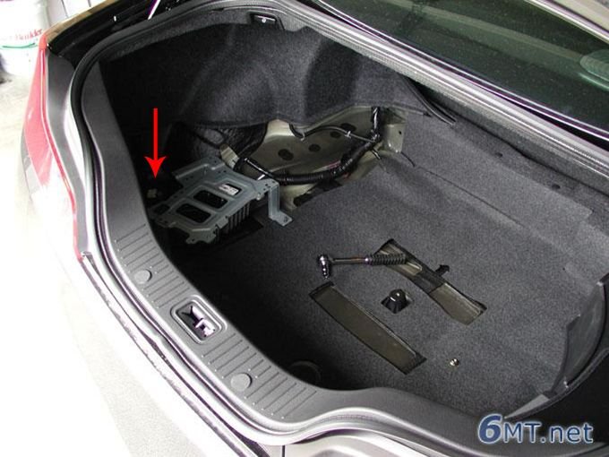

Bose amp is in the trunk, mounted on the underside of the rear window deck, driver's side.

Originally Posted by thjs
bit late but not sure where the bloody bose amp is
infiniti g35s 2007 sedan
has fuses for bose and bose speakers
Its located here in the coupe. Im sure its no different in the sedan.

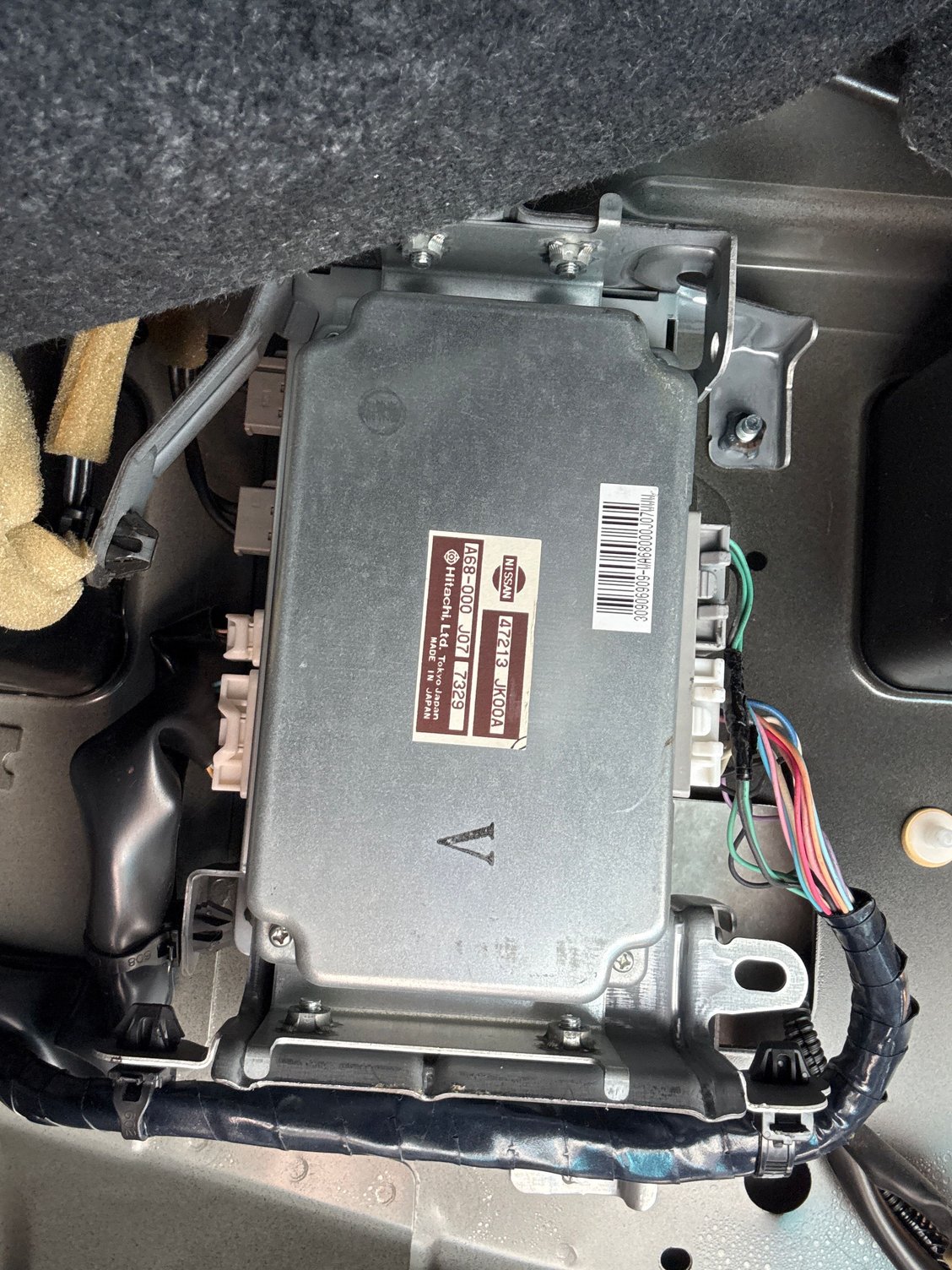

Old Dec 27, 2024 | 08:36 PM
  #698
thjs's Avatar
Joined: Dec 2024
Posts: 3
infiniti g35s
is it this
is it this, i’m positive it has bose because there are bose fuses.
Old Dec 28, 2024 | 12:04 AM
  #699
Scorpi0's Avatar
Joined: Feb 2018
Posts: 3,087
Likes: 445
From: LA, Cali
Hmm…doesnt look like it. Unless the changed the look throughout the years.

Old Dec 28, 2024 | 08:46 PM
  #700
05_SkylineSedan's Avatar
20 Year Member
Joined: Apr 2005
Posts: 649
Likes: 112

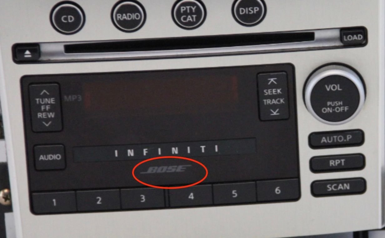

No, that's not a Bose amp. Not sure what that is, possibly the LAN or CAN controller? Bose amp - if you have it - should have a bunch of fins on it like the pic below.
I don't know what you mean by "Bose fuses" but if it's a Bose rig the word Bose should appear on the head unit.
