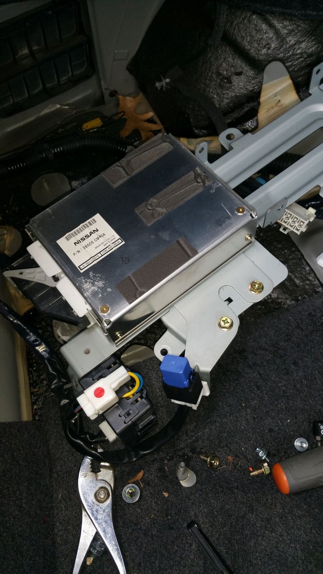

Also, What can I eliminate from this picture? I figure I cannot take away the rear driving control module but I can splice the bluetooth, eliminate the sirius and....?? Thanks

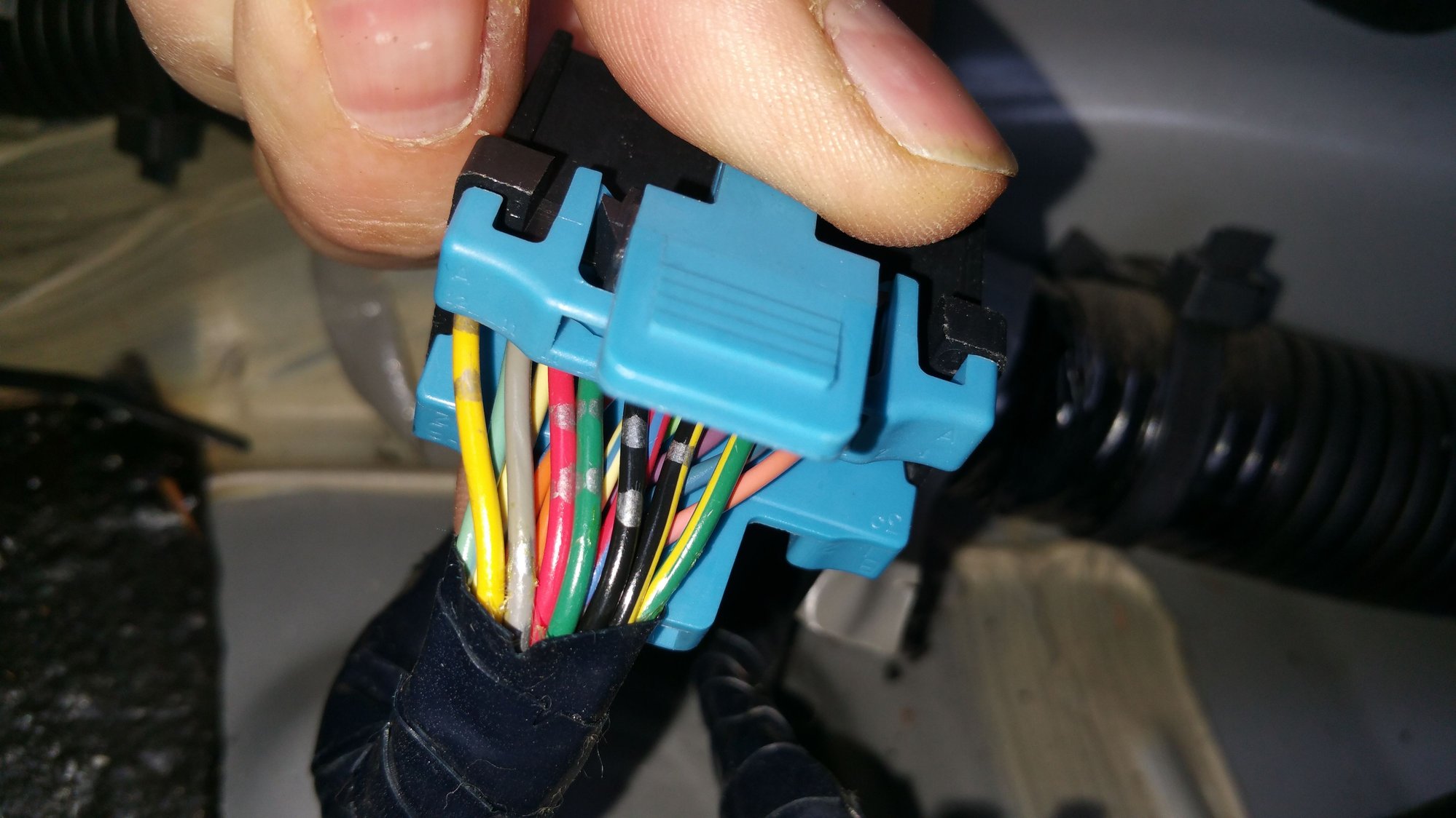

Ok. Are u able to tell me which wires I am splicing together because it seems like there are multiple wires the same color. I thought I had seen a diagram before on how to do this. Sorry for so many questions, I just want to get this right...
This picture shows the three pairs of wires (red/yellow/green) that have to be cut from the harness and soldered together. Match the identical colors and you're done.

Awesome! Thanks! Should I disconnect the harness and toss the module or just leave it plugged in and splice the wires?
Disconnect it.
You could try and sell it, but they're not prone to failure, so not many people need them for replacements, and you can't exactly add them to a car that wasn't equipped without adding an entirely new wiring harness throughout most of the car... so just remove it from the car to save weight.

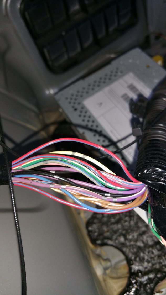

This is what is left besides the amp. I took out the bluetooth and the sirius modules.
I am assuming the reverse wire is one of these? Do we know color or a good way to figure it out? Thought it was purple but there are several. I am an idiot.
1)1 of Bose amp wire connectors...should I be using any of these wires?<br/><br/>2)Is it ok to leave the amp fully disconnected if i am going to install a new 5 channel? <br/><br/>3) since the amp is only 5 channel and there are 6 speakers to power, should i put 6x9 and 4 inch speakers on same channel or the 6.5 components and 4 inch speakers?<br/>
So I am almost certain that this harness has all the speaker wire connections that i need for the vehicle. <br/><br/>Is there an easier diagram to show exactly which wires are which? The factory diagram seems to be super confusing.<br/><br/>I know i am not the sharpest tool in the shed but I really appreciate the help and i know that this info will keep this thread alive and help out alot of people.

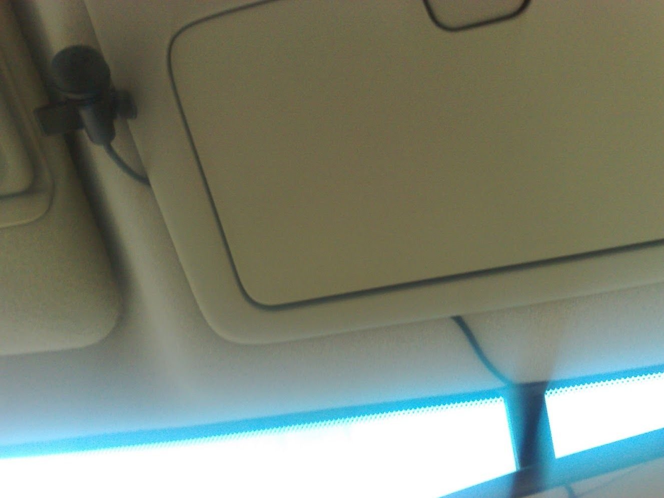

How hard would it be to change the mic in the ceiling? I'm trying for an oem look. Could someone splice a better mic in the ceiling? I'll be getting a Pioneer AVH-X3700BHS and it comes with a mic and 3.5mm input. Could I splice that into the ceiling or would it be better to replace the oem mic with that one and try to run the wire through the ceiling an down one of the roof pillars?
The factory location compromises quality to be hidden. You'll get much better quality having the microphone more exposed, like this:
