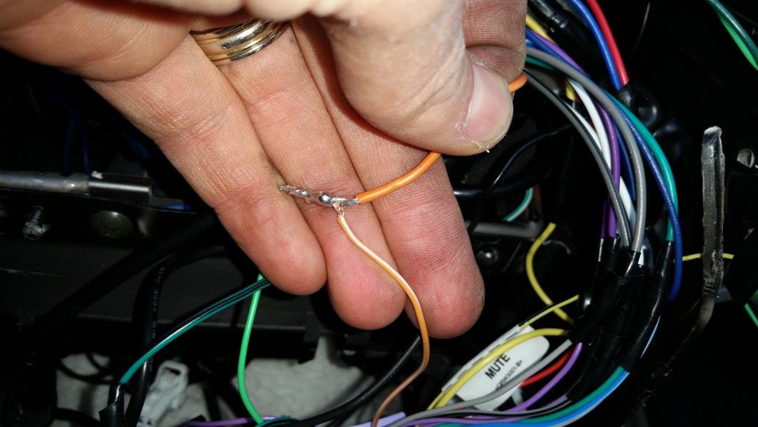

I did the double dinn install with a Pioneer AVHX4600BT using all soldered connections and everything works great except for the dimmer. So when the headlights come on, I don't have any a/c control dash lights, nor does the clock light come on. More concerning, is that my nighttime taillights are out too. Haven't run into a cop yet, but with short days and leaving work after sunset, I'm sure this will happen soon.
Any thoughts on how I can rectify this issue?

If you followed Wrathernut's wiring diagram exactly, the dimmer function should work. Go back and double check your wiring and soldering. But it really sounds like you blew a fuse or a relay somewhere during the installation if your dash lights and tail lights are out.

Originally Posted by Baconman6
Can anyone help please?
If you disconnect the dimmer wire, does everything work right?

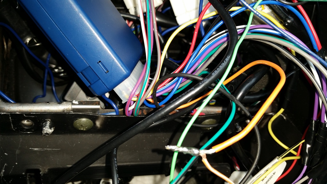

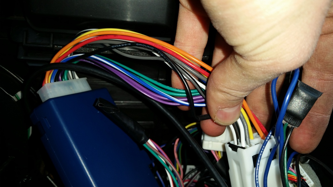

Thanks for the responses Wrath and G35fromPA
Here are my original soldering connections (see pictures).
I tried cutting the dimmer wire connection (between the PAC unit and Pioneer stereo head) and I still don't have dimmer/taillight functionality.
I looked at the kick plate fuse panel and none of the relevant fuses are blown. Checked the fuse/relay box next to the battery under the hood and none there seem relevant or grossly abnormal.
The dash is torn apart, so any help people are able to provide on a quick basis would be helpful.
Thanks in advance.
Thanks in advance.
There's two fuse boxes in the battery compartment, make sure to check them all.
After that, disconnect the radio harness completely and everything is working right before moving on, and make sure you've got the battery disconnected while you're doing the wiring.
The first panel next to the battery compartment contain two relays labelled daytime running lights 1 and 2 (which look okay). Then fuse panel with a combination of a few relays, larger fuses with top visible wire, and micro fuses which I checked all of them and appear OK. In side driver panel, I checked the relevant micro fuses which were all intact.
I then disconnected the white connector that goes into the PAC unit, and still don't have dimmer functionality (including taillights). Is this adequate for "disconnecting the radio harness"? Does this mean the problem is unrelated to the radio?
Btw - I always disconnected the battery when doing wiring.
Thanks so much for all your help.
If you've got problems with the light functions without the radio installed, you should probably hit up the lighting forums to narrow down the problem. Once that's fixed, try the radio again without the dimmer wires connected to see if that was the source of the problem.
Thanks Wrathernaut. Ended up making a post over in lighting:
https://g35driver.com/forums/general...ml#post7029911
Ended up being a blown fuse (#71; 10A) in the IPDM. Thanks so much for your help getting to the bottom of this issue. It's so fun to have the double dinn setup fully functioning. One of my favourite upgrades for sure.
