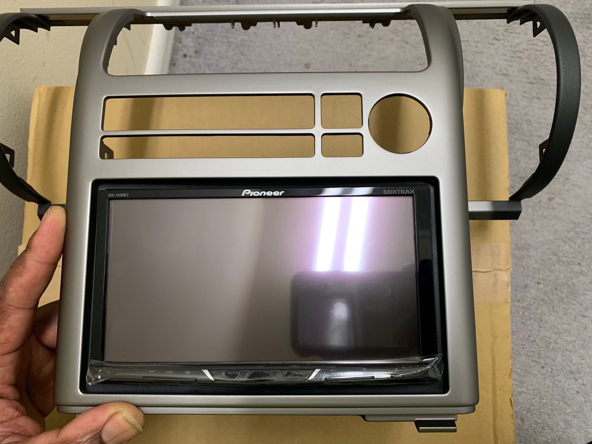

Old Mar 21, 2019 | 08:08 PM
  #2169
Siknin's Avatar
Joined: Oct 2017
Posts: 76
From: Virginia
04 TB G35 coupe 6mt w' Brembos
Just got the jdm double din in the mail today. test fitting. When I’m done and it looks like this I’ll be satisfied. Any tips on adjusting the PAC ROEM piece to get good sound from the Bose? Turn up the sound and turn the screws until it distorts then back them down?
