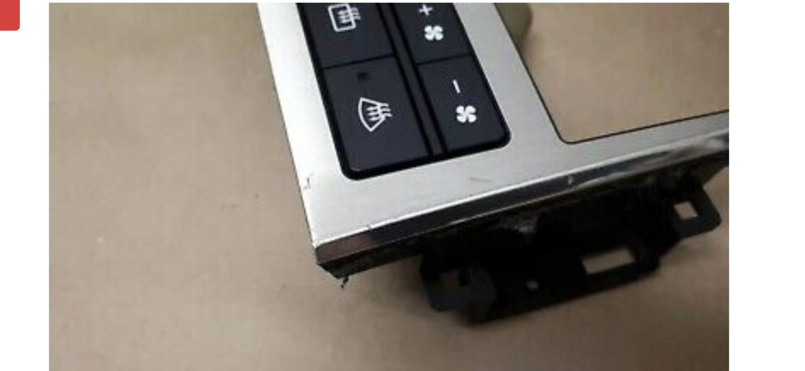

Here is the one I'm looking at. For an 06 Sedan.

If that is the actual pic of the one he is selling then it looks like its a navi trim.
The navi kit has an identical width of aluminum trim both above and below the buttons. The non-navi kit has a wider aluminum trim above the buttons compared to the trim below.
Heres some pics for comparison:
With Navigation:
Without navigation:
With Navigation:
Without navigation:
I appreciate it! I assumed this was the case, but wanted to make sure before having to deal with international ebay returns.
