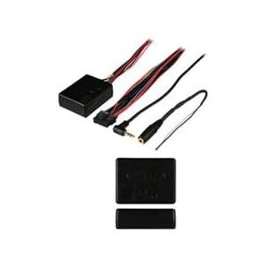

I'm putting a JVC radio in my daughter's 2003 G35 Sedan. There is a mini jack in the back, but is says it's for the bluetooth adapter. It does have a wire in the harness labeled "Steering Wheel Control". Any suggestion on how to wire in the Axxess ASWC? Think I could still use the mini jack? Will I be connecting one of the ASWC wires to the radio harness SWC wire maybe? I've read every post here (thanks for all the work guys! Great resource!) and done an internet search but no answer.
According to the manual - Page 102, Section B *6, the steering wheel remote plugs into a 3.5mm jack on the harness, not into the unit itself. That's where the ASWC plugs in. The ASWC still needs its control wires connected to the vehicle side as well.

I knew I should have included the model number:\ It's a JVC KW-HDR720. This is the only wiring instruction I've found for it (the other manual is just for operating instructions and doesn't even mention steering wheel controls.
No problems hooking up the PAC OEM-1 to the radio harness, just a little stuck figuring out how the Axxess will connect to the radio. There are only two wires left (unconnected) on the radio harness; a brown one for radio mute (could connect to the pink radio mute wire on the Axxess, though the instructions don't mention it...) and the light blue/yellow stripe wire labeled "steering wheel remote."
http://resources.jvc.com/Resources/0...T0722-002A.pdf
Can't find exact instructions, but it looks like you might just plug the Axxess into the 3.5mm female plug, and attach that single wire to the JVC's steering wheel remote wire.
But my recommendation is to call Metra's techs, they seem to be able to answer most of the questions people have had installing the unit.
