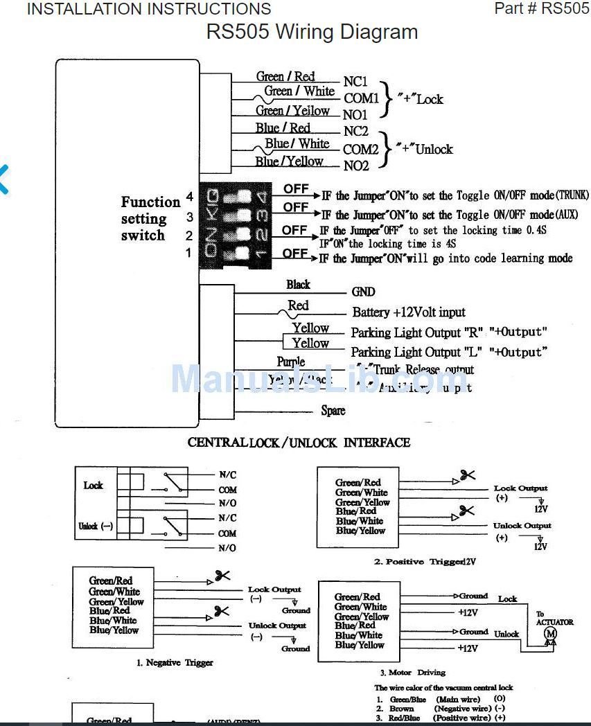

I am installing a Accele rs505. It's just a wireless keypad you can use to lock/unlock your car, like the Ford system. I've added it to two other cars without issue, but having a little trouble with the G. I have an 07 Coupe. I hooked up the system how I thought it should be done, but the locks don't activate. All I need this thing to do it unlock the doors. I have constant power and negative. I hooked the unlock wire to the unlock wire (light blue) in the driver door. I can here the device click. I can measure it passing voltage when it clicks, but the car does not respond.
Does anyone have a though on which wire(s) I'd connect this to? here's a link to the product on amazon. I do not need lights, or aux, or anything. just lock and unlock.

If I'm reading that manual correctly, the "sky blue" unlock wire in the door would need to be grounded to send the unlock signal, not +12. Can the rs505 do that? That little "Power Window Main Switch" in the door has a processor in it, it's actually one of our black boxes.

yes, it can do - signal. If you look at the bottom left of the diagram above, it shows a negative signal capability.
I guess what I really want to know is, should a negative signal sent to the sky blue wire in the drivers door panel trigger an unlock? If so, I'll dig in to how to get this thing wired up.

Yes I think so. Grounding that sly blue wire should be the same as turning the physical key in the door to "unlock". That may only unlock your driver's door though. I don't think you can tap into the master lock switch which is part of the 'Power Window Main Switch" because it looks like that's built into that circuit board.
