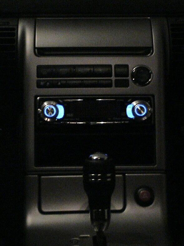

got a question & a request...
1) what bit rate did you convert the files to for each of the formats? (If I have to use MP3 I usually use 320kbps...)
2) would you mind taking & posting a pic of your head unit installed... would like to see what the DD finisher, A/C controller, and the dash pocket look like together with the Eclipse deck.

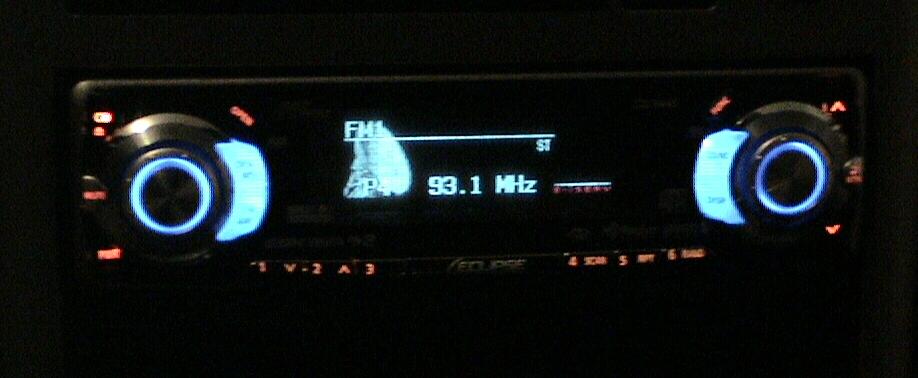

Pics.
Originally Posted by grizzly
Thanks, Miami, for your experiences/opinions
I thoroughly enjoyed Part I
Thank you. The bit rate was 192kbps.
Here are two pics. Sorry the pic quality is not better, but the forum limits me to under 100kb pics. As you can see, with the headlights on, I set it for amber lighting. Whether the headlights are on or not, there are 4 buttons that are always blue and you cannot adjust their brightness. If the unit was placed higher in the dash I think this might be a distraction, but it sits low enough where it's not. The blue also matches my Escort 8500 x50 display.
Attached Thumbnails Reviews.  I:  Audio system upgrade; II:  Various codecs versus WAV.-079r.jpg   Reviews.  I:  Audio system upgrade; II:  Various codecs versus WAV.-080r.jpg
