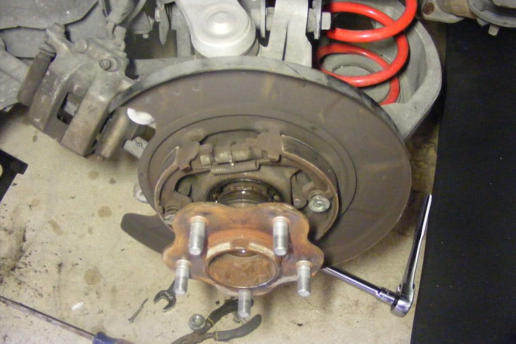

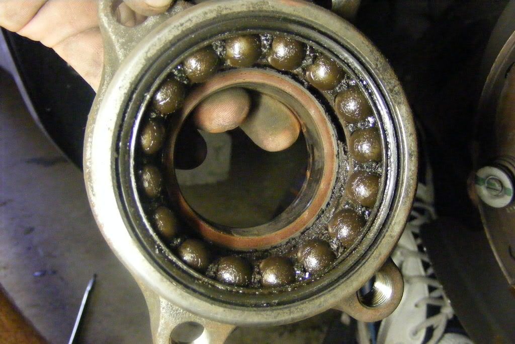

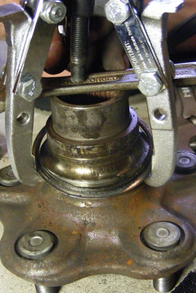

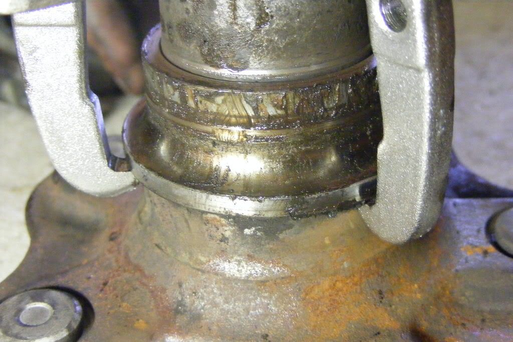

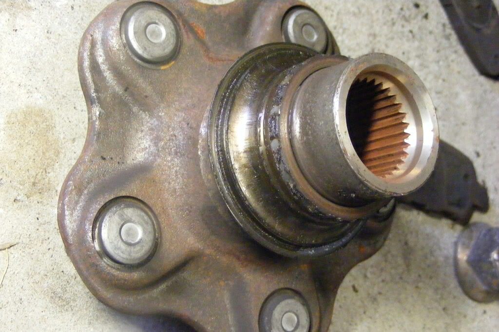

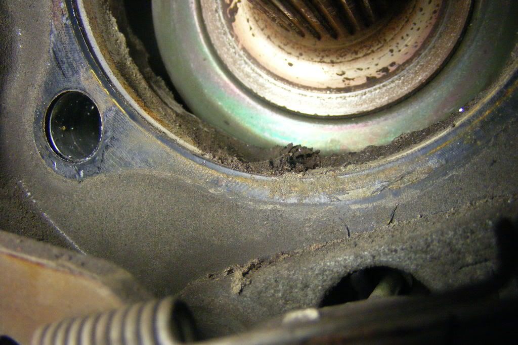

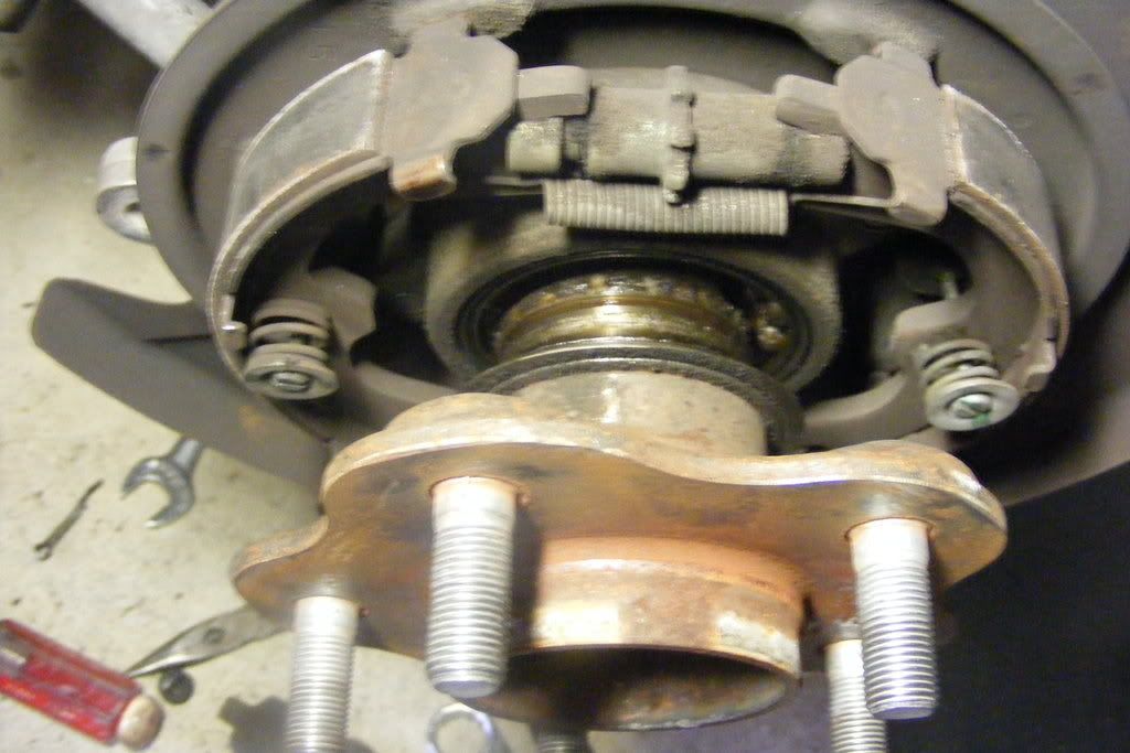

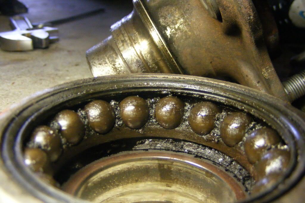

So this was the source of my vibration/shaking problem as well as the associated road noise. I should have figured something like this would have went bad. It was only a matter of time, especially after 113K!

Wow. Did you do this on your own?

Yea.. I'm stopping by the local Nissan stealership to pick up the bearing tomorrow.
Moog helped me out with some advice over the phone to reassure me it was the problem.

Dam*! That looks to be a tough job. Something I would not want to do myself.

113k? Do you use oem wheels or heavier aftermarket?
We see wheel bearing failure with heavier wheels or brake mods [heat] but usually last more miles stock.
But then again 100k is the typical design point for most components.

i would replace them all around. if one goes bad, the others are close behind.

nice pictures. After almost 100k my rear wheel bearings went. I had the same symptom as you did, vibration. When we put the car up on the lift, I could move the wheels back and fourth while it was still mounted to the hub, which was not safe. Mine is getting fixed right now.
