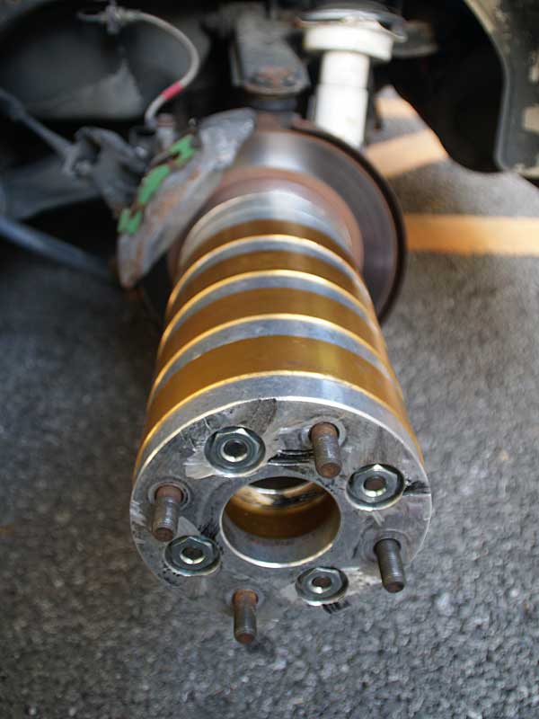

Originally Posted by GmetalG
Any truth to the claim that wheel spacers increase bearing wear and increase the risk of premature failure? Guy at my local shop refused to put them on saying it was asking for trouble. A lot of people use them on here but haven't heard of many problems?
A few mm or even 25mm should not be enough to wear out the bearings. Bearings start to wear just from the weight of the vehicle the moment they are installed on a car. But spacers do not wear them fast enough for you to notice any problem during the useful life of the car.
However, this the attached picture would obviously be a problem.
Attached Thumbnails Bad Bearing: pics.-2yvqucg.jpg   Bad Bearing: pics.-2vae1rk.jpg
Old Jan 17, 2011 | 08:44 PM
  #43
Blue Dream's Avatar
I drove ttrank's car solo
iTrader: (50)
Posts: 18,299
Likes: 1,488
From: By the sea, Tx
Wow^^
