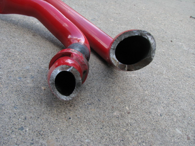

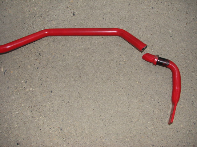

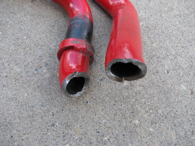

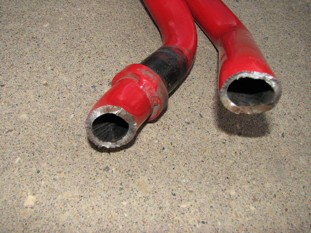

Not sure if anyone else has had this issue, but my Front Stillen Sway Bar just broke!
Installed October, 2005. Started making noise which I thought were the suspension arm bushings last fall (2009). Lots of noise a couple of weeks ago, and last week-end, I heard a big noise (sound of it snapping?)
Removed on the W/E (46,000 miles on the sway bars). Looks like it started as a crack last fall since part of the break is starting to rust. Finally let go last W/E.
I’ve never tracked the car, and though I’m an enthusiastic driver, am not overly aggressive. The bars are set on ‘medium’.
Stillen says that their bars are only warranted for 1 year so it’s not covered! I’m pretty disappointed with their response. I probably should have gone with Eibach which Stillen warranties for 1 million miles. Looks like they have more faith in other manufacturers than their own!
I can’t seem to attach the pictures right now, but I’ll try to later.

Here're a couple of pics.
Attached Thumbnails Sway Bar Summary!-img_0174.jpg   Sway Bar Summary!-img_0172.jpg   Sway Bar Summary!-img_0173.jpg   Sway Bar Summary!-img_0175.jpg

Exclamation Avoid the Stillen!
Originally Posted by Gsedan35
^Gordgee, I've seen that happen with one other Stillen bar set before. Wanna say it was posted on my350 in 06 or 07 IIRC.
Not surprised.
As I said, Stillen won't cover it. They claim that it must have been caused by hitting potholes or something, but I'm always very careful, and have only had one minor wheel alignment as a maintenance item done since I bought the car even though the car has always tracked true. Anything that would cause the sway bar to break like that would likely have been very noticeable at the time, and would have affected other things in the front end. I believe it was a manufacturing flaw and one of my engineer friends agrees.
Adam at Stillen offered a replacement front bar for a reduced price, but I've lost faith in Stillen. Why throw good money after bad? I asked if they would offer a discount on one of the other brands they sell that carry a better warranty, but they said it only applies to the Stillen! In fact, the price they quoted the dealer to replace my bar with the Eibach bar was a few dollars higher than the sale price per their site!
This has left a bad taste in my mouth for Stillen and I'd have to recommend avoiding some of their products in the future. Sorry Adam, I know you browse these forums, but Stillen's response in this case sucks!

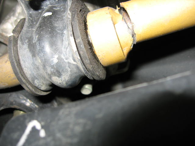

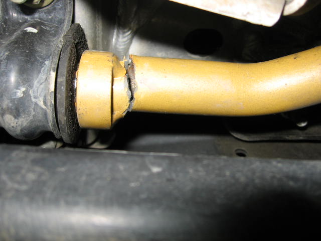

Stillen Front & Rear Bars...
What I found on My350 was a thread about a Stillen rear bar breaking:
http://my350z.com/forum/brakes-and-suspension-399/
Attached Thumbnails Sway Bar Summary!-img_0279.jpg   Sway Bar Summary!-img_0280.jpg
