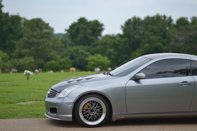

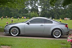

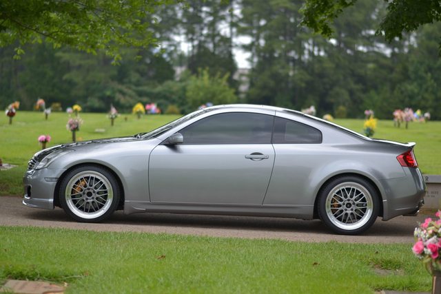

Old Jun 16, 2013 | 10:18 AM
  #344
ItsA..Gthing's Avatar
Joined: Nov 2012
Posts: 2,083
Likes: 218
From: N.C
Tnx^^ You sure the tokico springs for the Z are not going to do the same thing..Right now Ive got the Tein H-Techs(g35) version, and the back is slightly higher... .6ft and .3 rear
I want to get an even 1.1 all around.. Seems like its hard to get a hold of the RSR springs..Want the ones for the g35 coupe which advertises even drop of 1.1...
Old Jun 16, 2013 | 10:23 AM
  #345
Joined: Nov 2012
Posts: 2,083
Likes: 218
From: N.C
G35/350Z aftermarket coilover, springs and shocks spec's w/updates-vtco5q7l.jpg
G35/350Z aftermarket coilover, springs and shocks spec's w/updates-mfkcsh2l.jpg
Couple shots on half a tank of gas..Other pic I had like no gas..To me the drop is like the 350z version..I see no difference..
