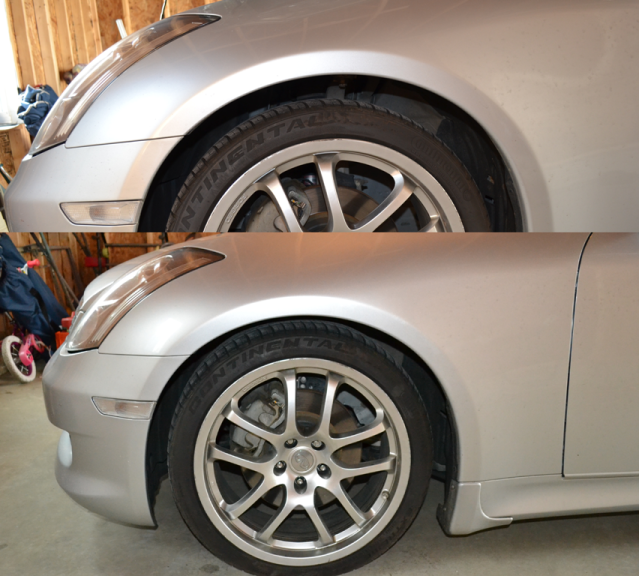

if i where to get stock 350z springs (front) and put them on my 04coupe (front) will it drop it some? i dont want to have bad camber or rough ride,so if theres anything i can do other than getting a coilover setup,or crappy lowering springs that will make my ride rough, can you guys chime in and let me know?
just want a decent little drop in the front, rear is fine.
btw im on stock 18's with brembos
Old Oct 30, 2012 | 01:13 PM
  #300
LoSt180's Avatar
Joined: Mar 2011
Posts: 2,796
Likes: 468
From: Maryland
350Z springs provided me with a 3/4" drop in the front. For the rear I had to modify the rear perch to get any drop. Since I have Sport package, springs rates are the same and ride is pretty much the same. Camber arms are recommended with any drop on these cars, that slight drop still put my camber out of spec.
Before & After shot on OEM 350Z springs
