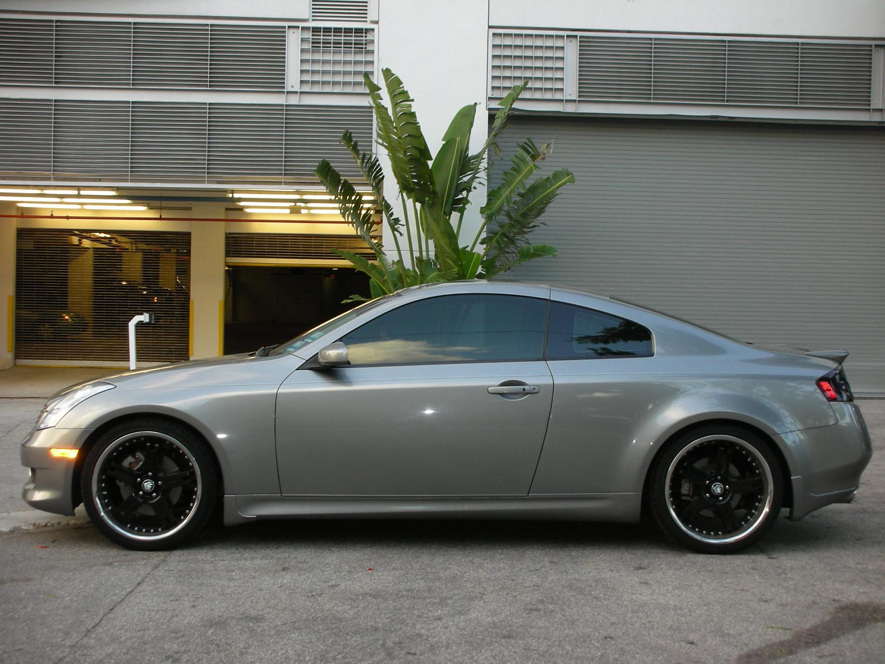

CHANGEOVER, I say go for it. Having a 2006 coupe (same spec as yours) I did most of my research by comparing the data in this thread for the different springs, my priorities being:
1. Minimal, but effective drop......NOT requiring a camber kit .
*Stick with .8 or less per Nissan-Infiniti techs to get back into proper alignment - see attached alignment data done just after install (and I do have 20" wheels).
You may've seen this, but also remembering to add .5 to the 350Z drop (.3 front, .2 rear for the Z) when applied to the G35 coupe.
Needless to say, we get an an average 3/4" drop, if you know what I mean.
2. Minimal changes to spring rates - especially increases, so as to not afeect my stock but upgraded shocks. (Sport suspension package)
Tein H-tech 350z (fronts are progressive, rears are linear)
358/375 F+14% R+11%
Transfers +3% roll stiffness to front
Stock Coupe 6MT Spring rates are the same rate as the 350Z spring and the sedan with the sport suspension:
314/342……..Rear – 427 with Sport-Tuned Suspension Package.
Still gonna get Tokico HP Blues, but with essentially the same spring I don't suspect I need to rush.
Sport suspension shocks should be just fine for many miles (I have 26,700 now), plus, I want the Seibon Hood and/or K&N CAI and Air Filter combo before the shocks.
Those were my main issues and below are some before & after pics.
The drop I can see and feel as I ride, including all the usual benefits of lowering:
**More responsive throttle/less drag
**A tad quicker and shiftier
**No more body roll noticed (someone said I may get that).
**Even more stable and buttoned-down, if you will.
I love the new driving feel, though it felt just fine before. TRANSLATION: Bought the car in Nov. 2006, yet waited almost 4 years to upgrade springs.
Generally speaking the drop is barely noticeable to the untrained eye, although the roofline is CLEARLY lower as I stand next to it. Which belies the tasteful, "almost nothing" drop (for you hardcore racers).
That said, if you're a car guy like me, it's kinda like a BMW 3-series with a sport package/shorter springs, where the fender gap is largely gone.........but not quite seeming to sit on top of the tires (like on the BMW). Dead giveaway.
Long story short, do the changeover. Now. Pun intended.
I'm gone.
