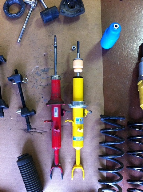

Side by Side... sedan shocks and the Bilstein Applications
Attached Thumbnails G35/350Z aftermarket coilover, springs and shocks spec's w/updates-side-side.jpg

That definitely looks like quality.
I can already see the comfort with that fat monotube.
