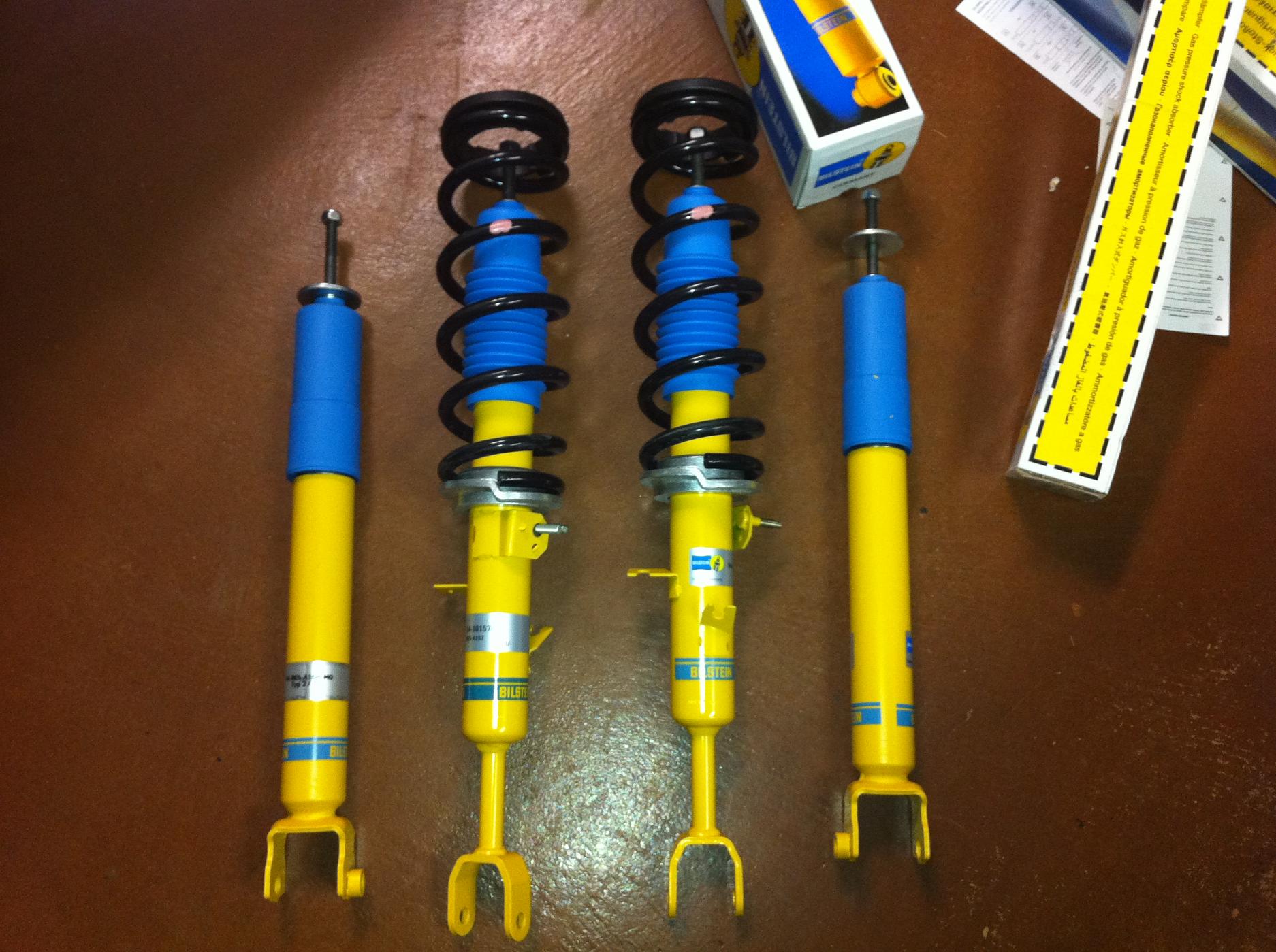

Bilsteins for 350Z and G35
I notice that nobody here has posted any pictures of the Bilsteins shocks for the Z and G.
Anyway, I have attached one, of the B6. The image features the front 350Z revised springs. As you can see, the piston length of these shocks is quite short, making it perfect for lowering.
One thing to note is that unlike the OEM or many aftermarket configurations, where applications for the Z feature slightly shorter piston lengths compared to the G, the Bilsteins utilize the same piston length between the two applications. In other words, the Bilstein monotube B series shocks is a one-part-number-fits-all between the Z and the G.
The Bilsteins piston lengths on these shocks are matched with the Z. What this means is that these Bilstein shocks are perfect for lowering springs for the G coupe or sedan.
I would recommend these shocks over any Tokicos. They have a BMW-like rebound. I don't know what Tokico is thinking, but the rebound of their shocks are simply terrible on all their shocks.
