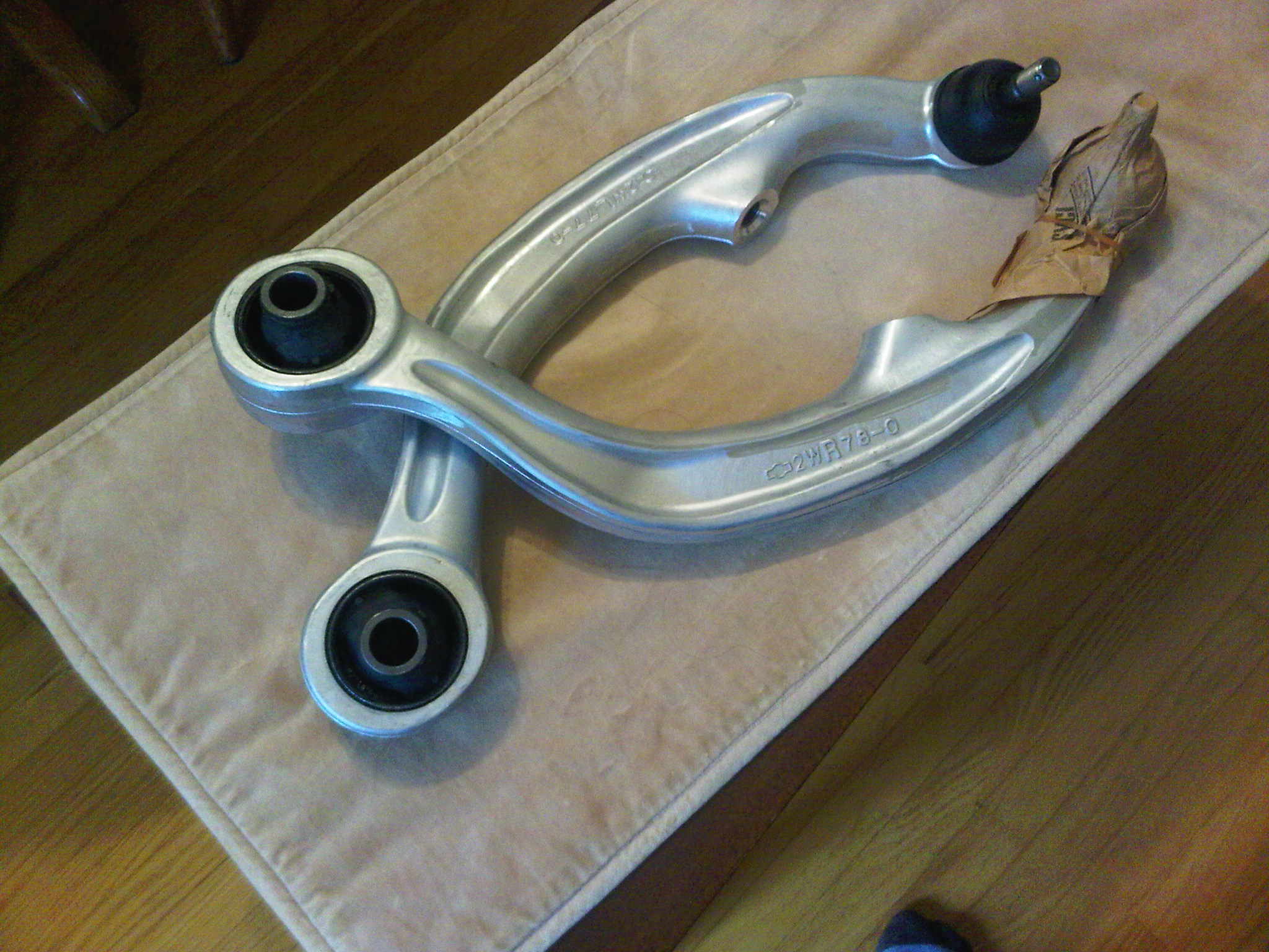

I just got a pair compression rod from TaiWG35 TODAY, Nice stuff, unbeatable price. hope this will get rid of my clunk noise.
Attached Thumbnails Suspension creaking noise - NOT SUSPENSION-img00197-20100918-1606.jpg

replace compression rod fixed the clunking noise. the ball joint has a little play, almost unnoticeable.
