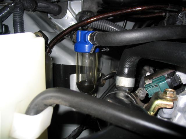

Here's my level after 250 miles of high speed driving.
Edit: Please include the type and weight of oil in your posts of this type. This was with Mobile 1 5W-30.
DaveO

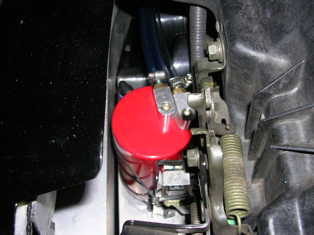

Cool
My car must be a freak.......
Now with 27K miles on her.....boosted w/ Vortech.....I can't tell that I use even a drop of oil between 4K changes.
I installed a catch can on top of my intercooler when I installed the SC, and hooked it up the same was as described here.
I can't see any oil in the lines or in the view tube on the can.
Oh well, knock on wood.....car is running GREAT!
