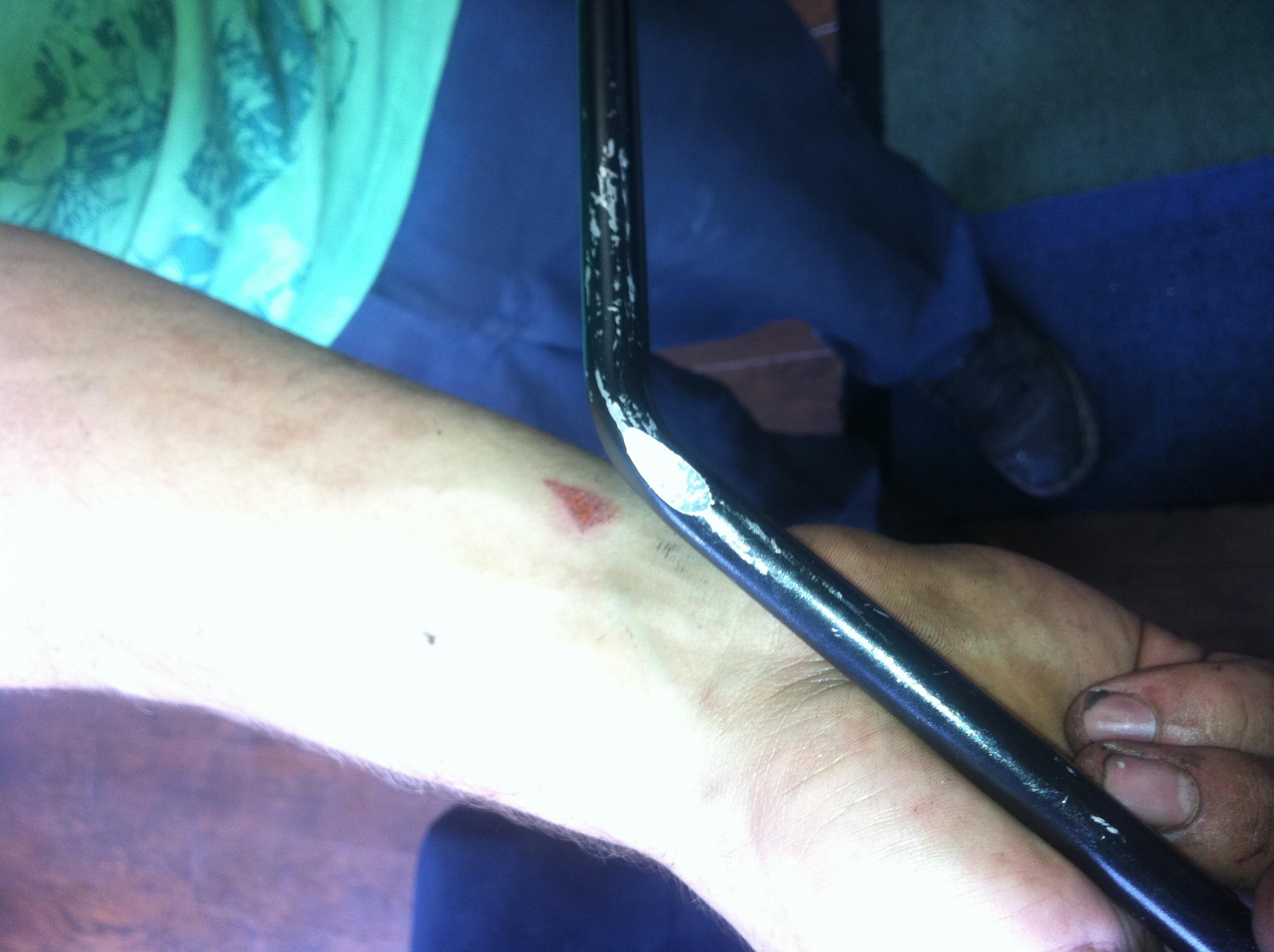

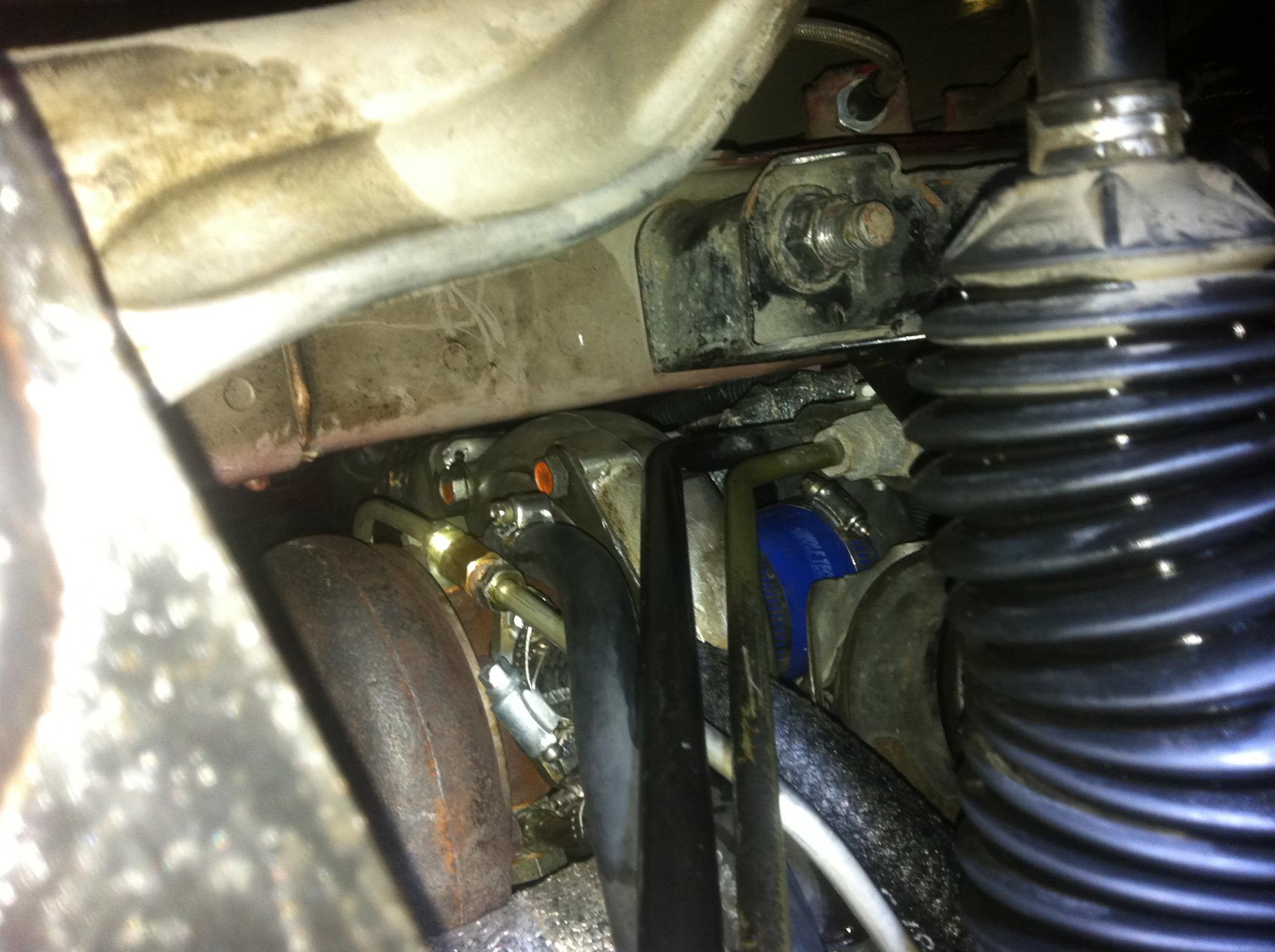

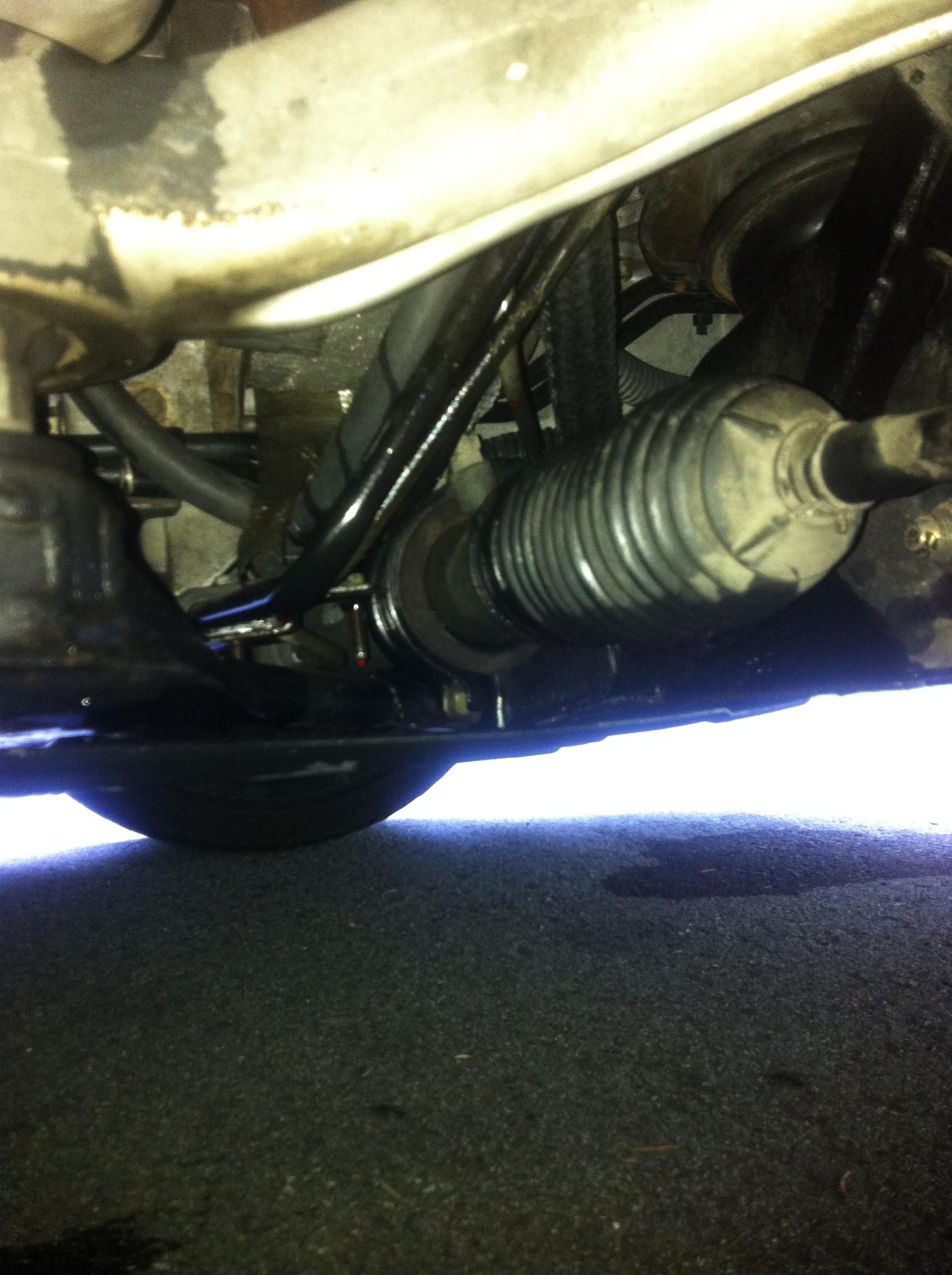

A few days ago I got in the car after a few days away and couldn't turn the steering wheel. I looked down under the car and there was a big puddle under the passenger side behind the front wheel. The boot was wet on the bottom and there was red fluid dripping down off the skid plate between the test pipes. (first pic) I put out an APB in the canada section hoping for some guidance on possible problems and Dustin (red35) indicated he had a similar problem with his car at about the same time... basically low pressure steering line rubbing against a compressor housing.
Sure enough, I limped the car over to MNR after topping up the fluid and made it there (20-25 minute drive) just as the pump started to whine again. Close! Had a couple smokey scares on my way but it was just fluid spraying on the test pipes from the wind... as I expected but I got a few worried glances from passing motorists.
Anyway, in the hoist they took a close look and sure enough- exactly as Dustin had indicated (shown in second pic). Third pic is the actual line pulled out. They fixed this with a similar diameter line and just bent it according to OEM but then just modified where it was bent near the compressor housing so that it would clear it by a larger margin.
