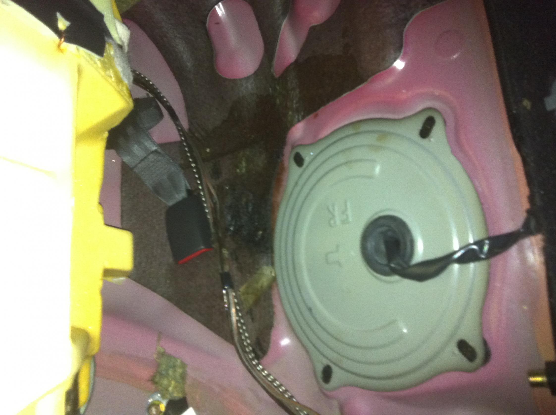

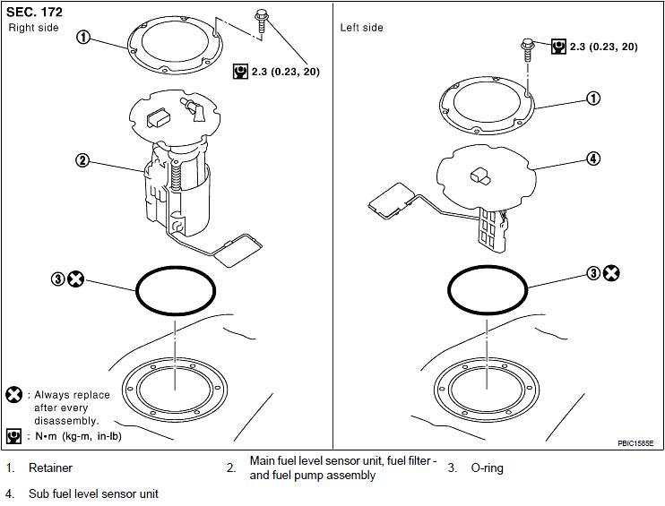

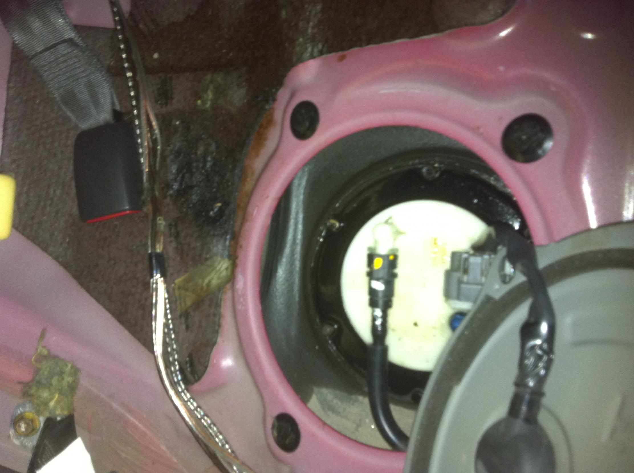

Eh guys... well here is a couple photos of my current issue. This is the location of our fuel pump under the passenger side rear seat. As you can see there is a pretty substantial stain from leaking fuel under there and some moisture (fuel) on the top of the fuel pump. Looks like badness to me!
Anyway, turns out the part I need is 7 bucks from Nissan (notice the X next to the O ring? Yeah, that one)- maybe a bit more. Looks like a quick fix judging by the FSM.
Any tips or tricks with the install / removal?

Get a new o-ring... common issue

Dont let the oring get wet with gas as it will expand.

Did you run the car with the top off like that? Make sure it is not the lines leaking???

I'm going to run it a bit more when I get back out there so that I can actually visuallize what's going on back there- and ensure it's the gasket (which I'm going to replace anyway).
I'm 99% sure it's the O-ring but to be honest I didn't have a lot of time before I left to mess around. Well, not with the fuel system anyway! Priorities.
