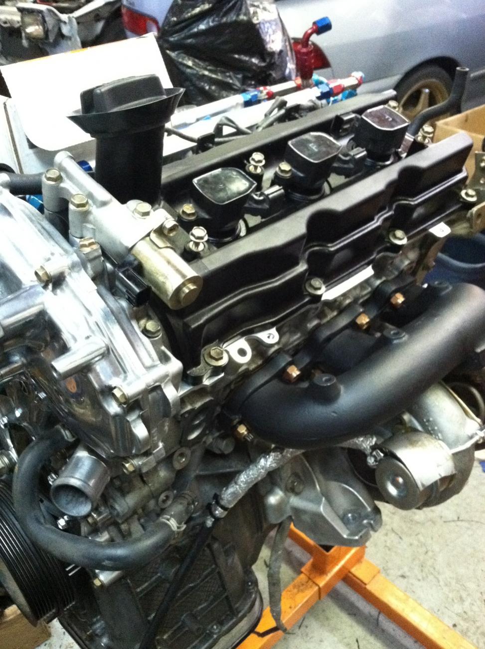

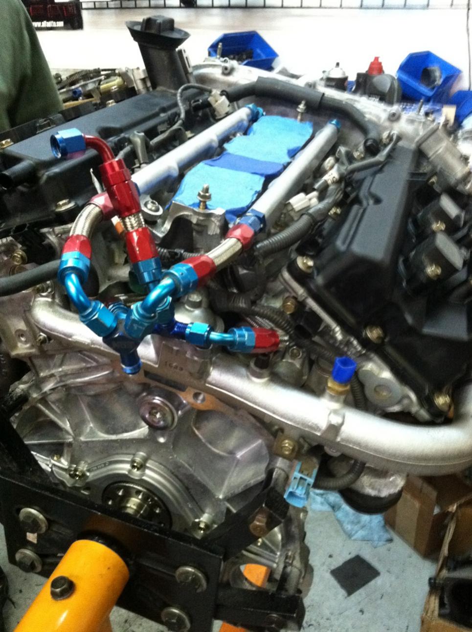

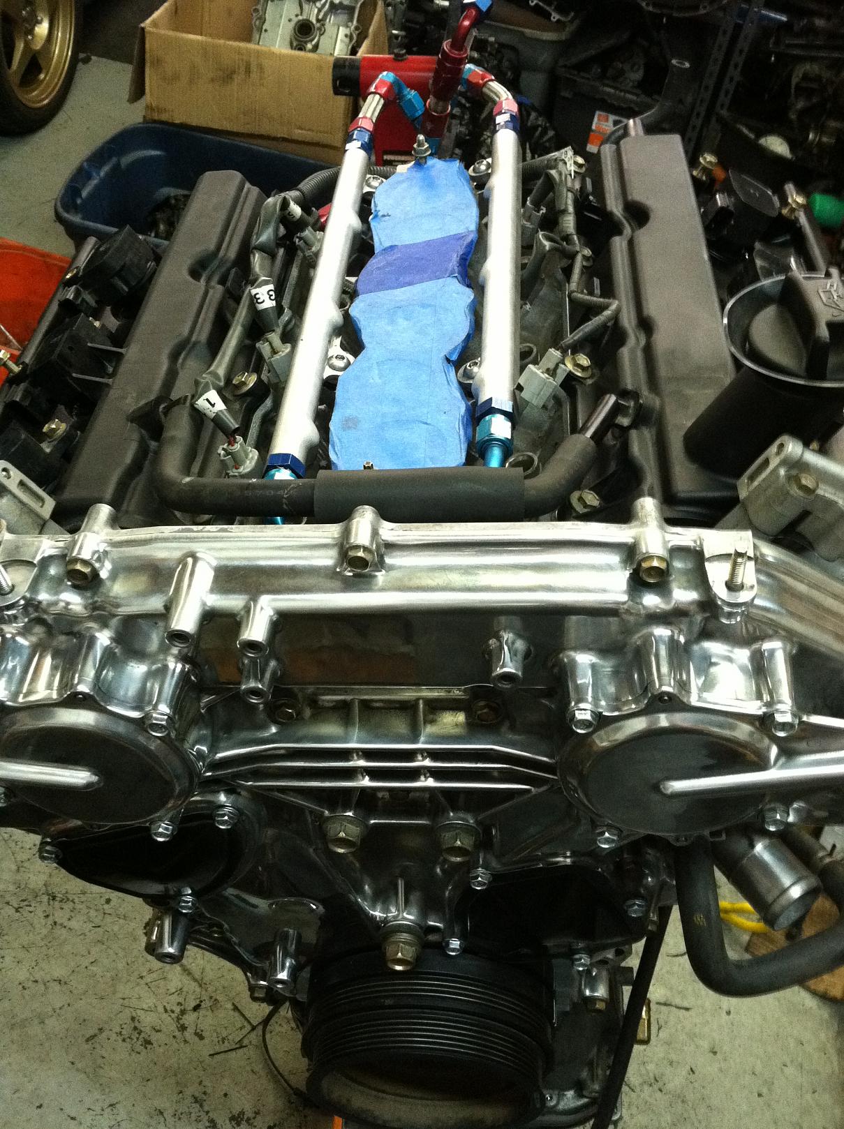

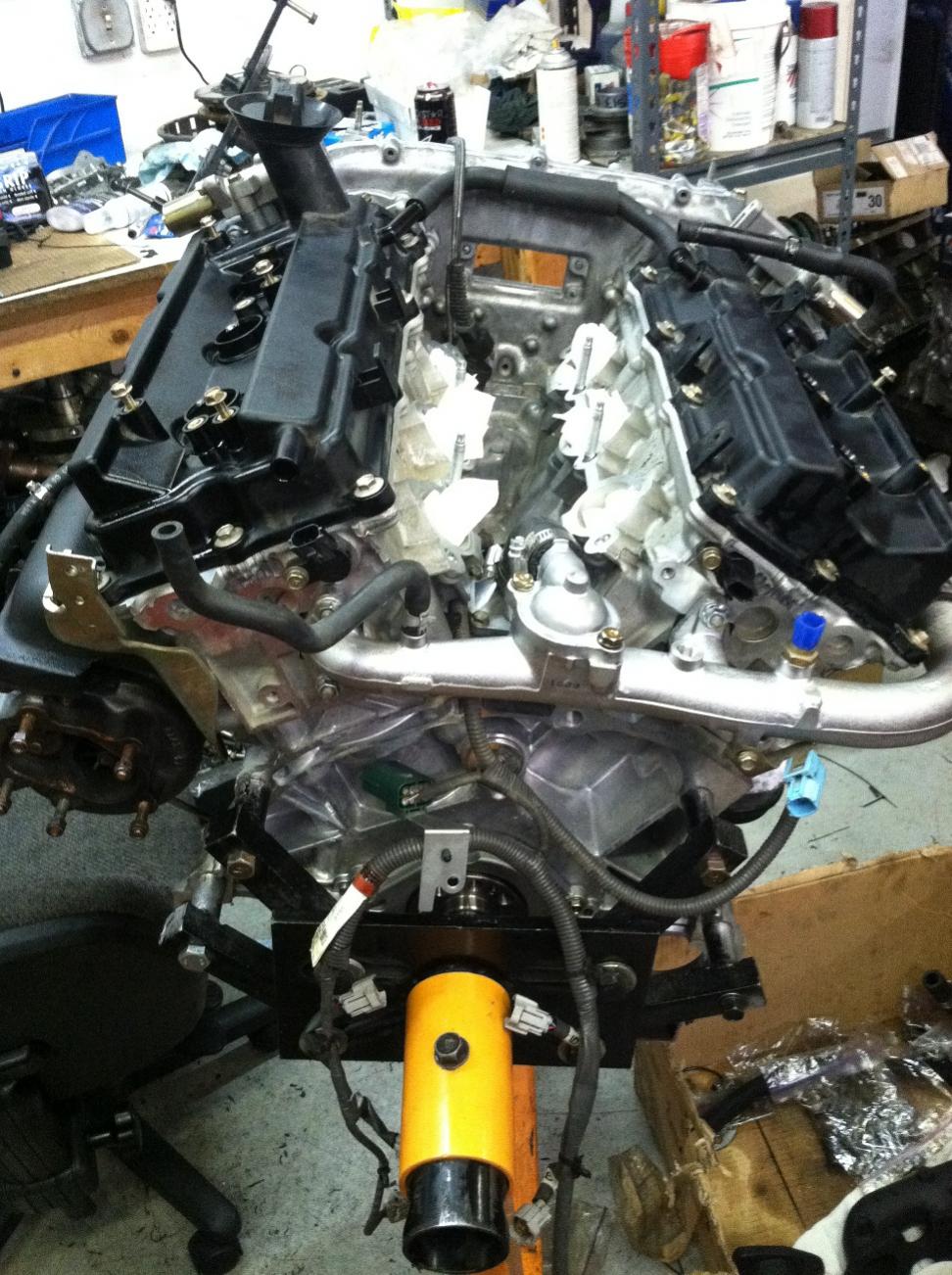

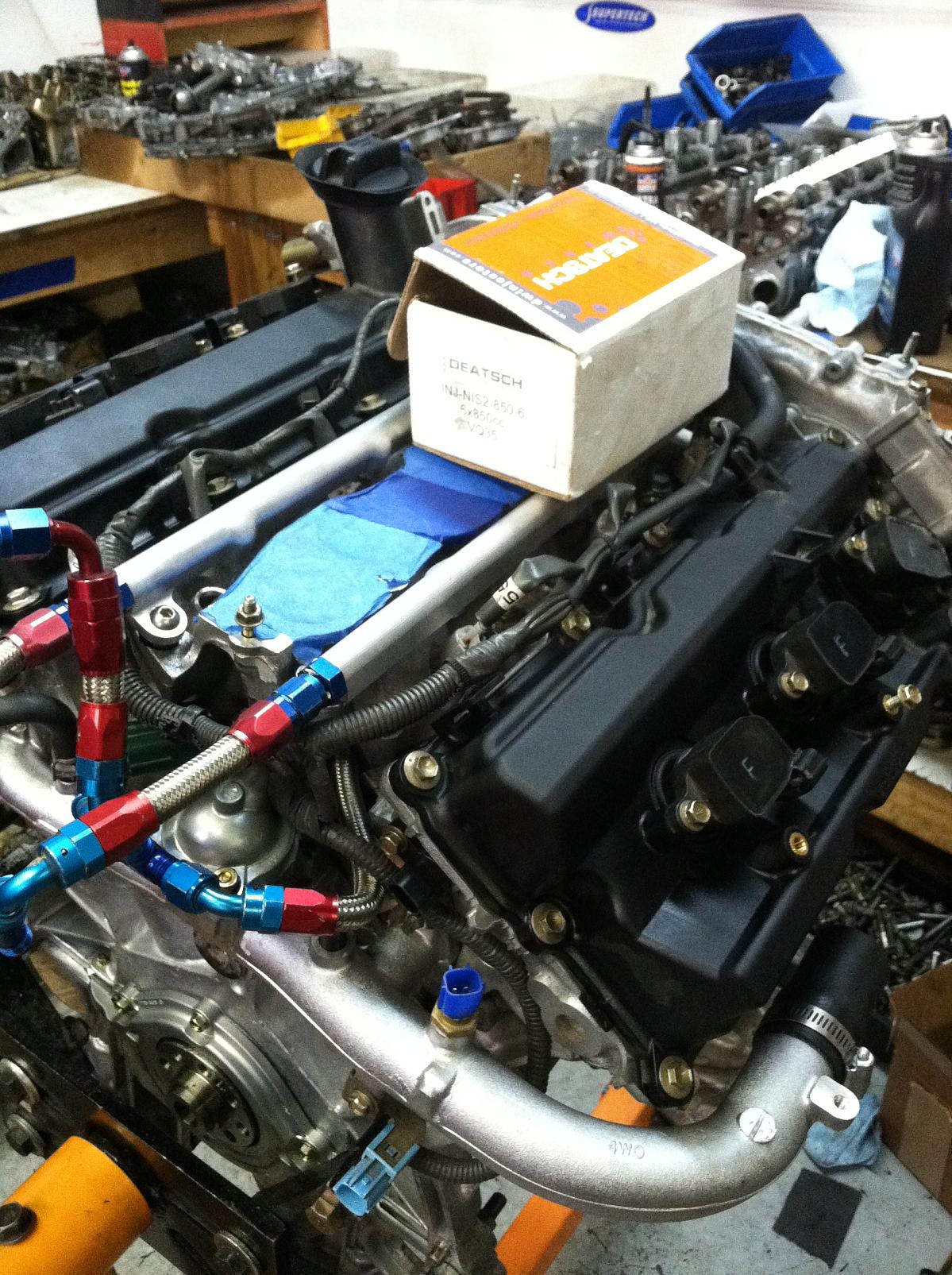

Eh guys. Well I was off the radar a bit over the past couple weeks. There were a few things going on but not too many pics were coming in for me to post-
The engine is back together again and the turbos are being mounted. Judging by these pics at least one is mounted- I know the whole thing is really starting to move now. A couple of little setbacks, but overall I think things are coming together at an expected rate. It's slow... it feels really slow to me but I get it: When I'm able to do this kind of work I'll be more critical- as it is right now... I just want them to do it right. BELIEVE me... I want them to do it right and not being able to turn around and say to me "sorry your engine blew up but you were nagging us to get it done and this happened."
So- suffice to say... no nagging. Okay, well maybe a tiny bit of "is it in yet? Is it in yet?" but I'm doing my best. I know what it sounds like... suffice to say the anticipation is almost the same.
My HFCs sold and the test pipes should be there by now (I was told thursday) for when things are ready to finish off. Mike, their installation specialist, is in the groove and working hard on getting things done. This is reassuring to hear because from having watched him work and talked to him at length before when he gets into it... he's into it.
I noticed in a couple of the photos the Pathfinder cooling upgrade is on, and of course the polished TC looks great. I see ceramic coated manifolds onboard as well and the fuel system is finding its way on. If you're wondering what the box is in the one photo- it's the DW 850cc injectors... These will be amply fed by the DW300 lph pump and the RFS from Dustin. You guys all advised me not to skimp on fuel... I didn't skimp on fuel. Speaking of which- I still have Gord's 680 high impedence injectors... if anyone happens to be looking.
I just paid off some debts so now I'm on the prowl for the quaife and I have my sights on the 100 cell mil.spec cats that can be welded in further downstream on the exhaust. I want to see how bad the exhaust is first- I'm hearing different stories with different setups... like many things it seems to vary on a build to build basis.
Anyway- on to the photos. More coming soon! (I hope)

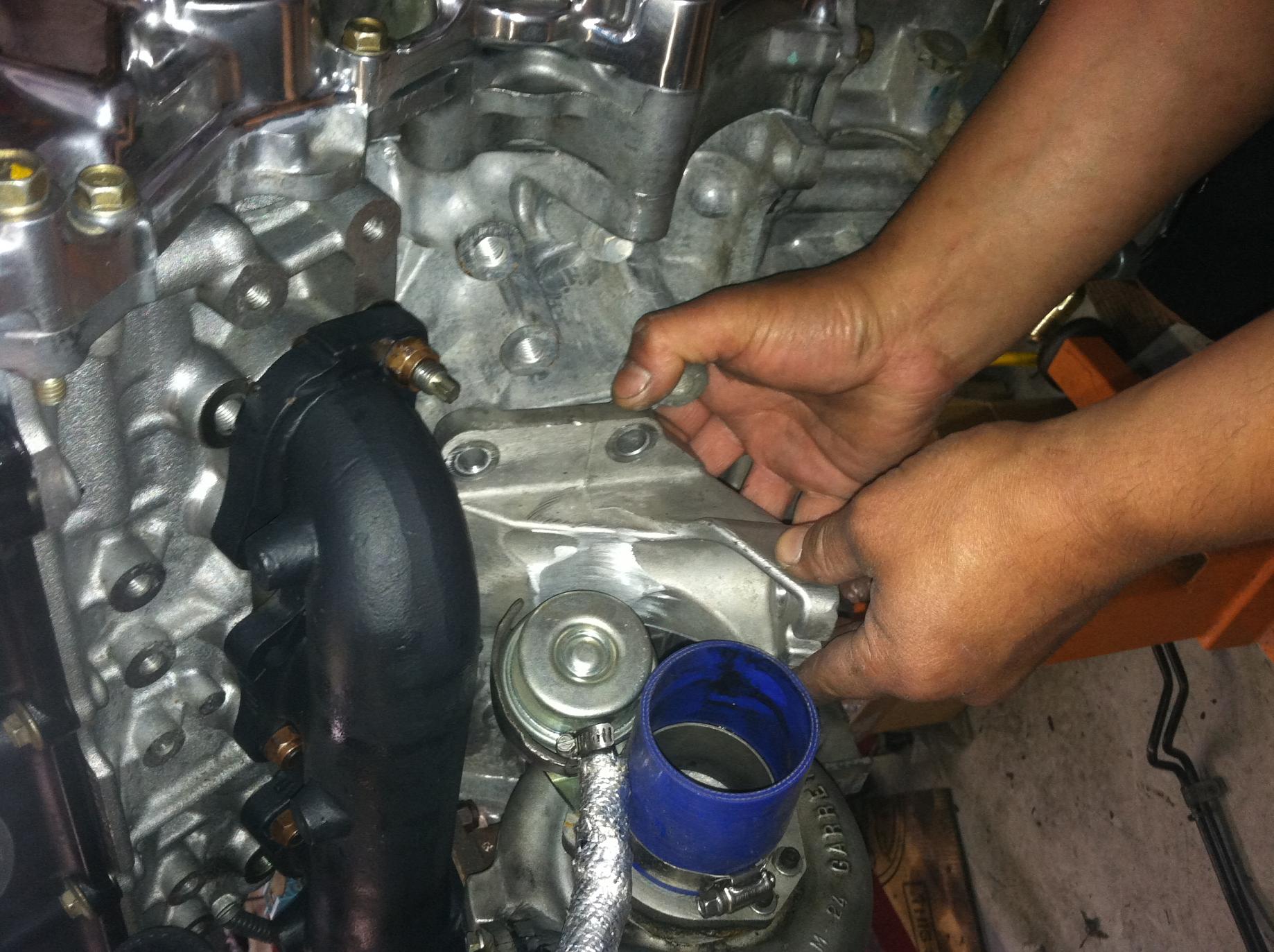

This thread can't be all about me just bragging about things going right... Occasionally I have to help some folks learn a thing or two- especially if you're installing the 700BB kit into a G35.
Anyway, one of the things that was mentioned to me during the reinstallation is that when you go do actually install turbos, the motor mount needs to be trimmed down a bit so that the turbo will fit properly. I'm not sure if both are inhibited the same way- maybe someone can chime in to that effect.
Unfortunately, this is one more thing that Progressive didn't do and as a result when they torqued up the studs that hold in the trubo they actually bent the actuator bracket. Mike at Intec got this sorted out and I'm told that things are snug as a bug now!
