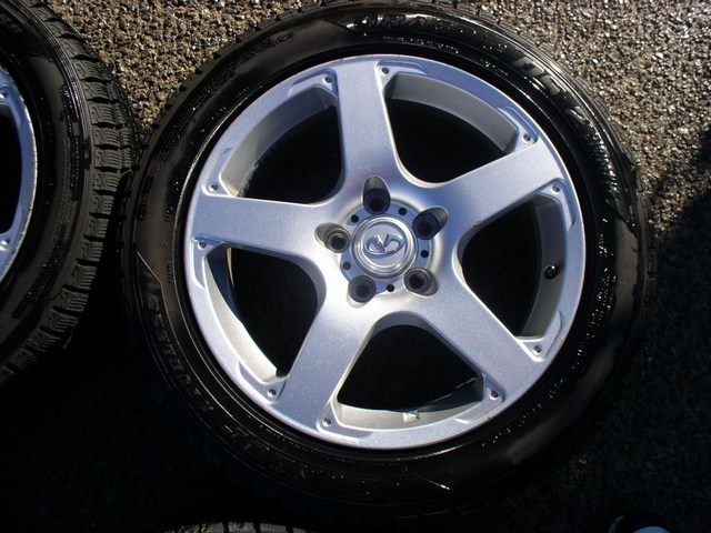

I have another guy selling his 03' sedan rims with 215/55/17 snow tires...
Do alot of coupe owners go non-staggered?? I want it but I don't know what to do! Help!
Also can someone confirm the attached wheel is off a 03' sedan?
hardly any coupe owners go unstaggered, the few that do are usually doing so in the winter, and most have been okay, so you should probably be okay with that setup

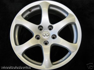

yeah I have the same size snow tires on my coupe for the winter I saved the wheels from my old sedan to use instead of the oem 19s mine are the same size except my sedan was a none sport model so I had the six spoke rims. 215/55/17 all around.

Cool Confirmed...
Confirmed - G35 sedan 6MT Sport wheel...
