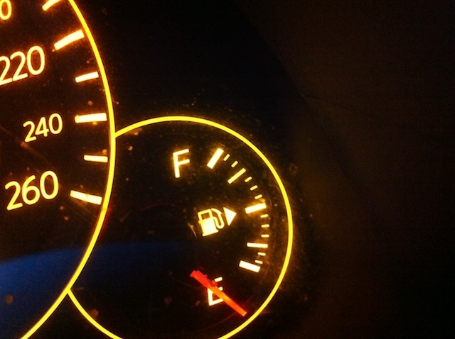

Ha! I seem to have managed a new problem then all the others in this thread. My gauge isn't reading at all. It moves a little when you turn on the car, but stays waaay below "E". It's kinda hard to tell if it moves as you use gas, as there is very little place for it to move down; I guess I could stick a sticky on the dash to mark where it was when I filled up.
Thoughts? Without replacing a sending unit, how would I check its operation to see if the unit has failed?

Is your needle stuck below the post, below empty like mine is?

It is stuck like so:

YES, exactly like that!

I had it fixed once in the spring of 2011. Then I noticeed that the needle bounced dramaticly with my weak, 6 yr. old battery, starting this winter. It bounced to the back side as in the picture. A few weeks later it bounced back to the right side and worked fine. Then it bouced to the backside again when I delayed turning the starter switch from "on" to "start".
I have replaced the battery and haven't seen it bounce since. It goes back to the shop to be fixed when I can afford it.

Well, one more data point: The Low Fuel light continues to work correctly. This seems to indicate that the fuel level sensors are working correctly and it is an instrumentation problem. Ugh.

Right. It's not the sending unit. It's the gauge itself. In my case I think it was caused by a weak battery when starting the car.

Mine did this after my battery was replaced. I made the mistake of having 3A come out to replace one on the spot. It went from dead old battery, to new one but the person left it in accessory mode, new battery drained overnight, new 3A guy came out the next day and jumped the dead, new battery. The surge spun the gauge around just like that.
Since 3A was paying, I took it to the dealership. They took the dash apart and put the needle where it should have been. I haven't had a problem since.
