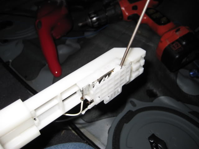

Mine were smooth except for near the bottom, cleaning still helped.

Thank you for posting this fix!!! Just did this on my g, and my meter went from slightly below the E line to more than a quarter of a tank. My driver side board was a lot dirtier than the passenger one. Now iDont have to panic about my gas level anymore, cause iCan get an accurate reading now!

My car started doing this after my last trip to the dealer. I'm going to try cleaning both units this weekend, just have a question, I've seen the pictures where the units have been taken out of the tanks, do I have to remove the little white plactic cover holding the metal arm or are you guys just cleaning the sides of it?

Yes, remove that little cover, otherwise you can't access the contacts, once it's out, it's *really* obvious how to remove the cover, easy too.
