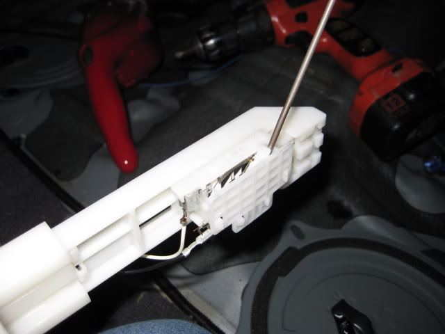

Just did this however I still cannot fill up with more than 12 1/2 gallons. The driver side was real dirty however the passenger side was not. Maybe I'll clean out the passenger side again just to make sure. Also, do the floats face the same way (forward towards the front of the car?) The following illustration shows the float (#11) facing towards the middle/driver side side.
Anyone?

^^^ be sure you didn' t bend out that thin bar that it doesn't make contact anymore on the upper scale.. did you take that small assembly apart to clean it, the one at the other end of the floater.. there are no screws to lock it, just 4 clips.. this piece.. i suggest you move the floater up and down slowly and see if you hear a clicking a sound.. it should make one as it passes each bar / notch
I don't remember hearing any clicking while moving it. I'll take it out again and do a little more inspecting and cleaning. Thanks for the assistance.
it's not much of a clicking sound, but you will / should hear something as the metal piece goes thru each bar if the contact is good..

Took out the passenger side this morning and realized that the black hose/bundle from my HKS pump was wedged in between the float and the sensor limiting the float arms movement. I guess I wasn;t so careful when I re installed last time. Filled up and got a full tank.
THANKS!
