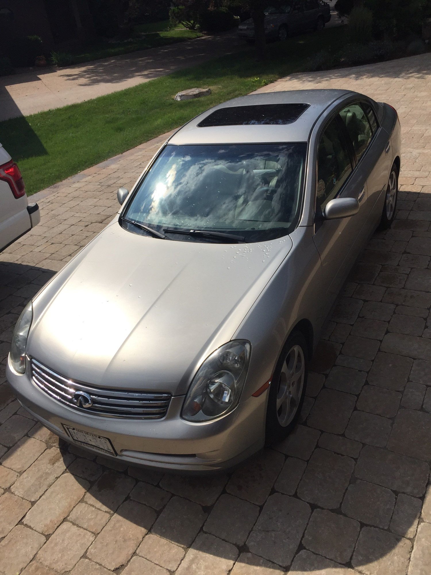

2003 ready for summer
My G35 has been sitting for a few months (besides the occasional start up) and got her revived today. I think it's time for a new battery as it doesn't seem to hold a charge - added some distilled water and it's doing a little better but the battery is 6 years old now so...
Minus a few other somewhat minor issues, it's running great and still young! 126k!
The plan was to sell but I think I'm gonna have trouble letting that happen. Might post in classifieds soon though, see what happens
