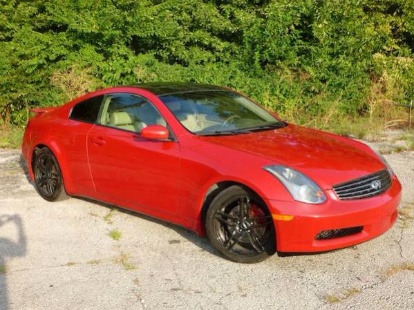

G35 mod list
Looking to ad as much horse power from bolt on's as possible without anything too major like turbos or super chargers... Let me know what works best!
---05 g35 coupe 5AT bone stock

Here's a picture to let you see what your working with

Thumbs up Power Adders
There are things you can do to add horsepower to your "G" such as. You can add an intake, catback exhaust system, HFC's, headers (although some people say adding them isn't worth the headache) I beg to differ. You can add a plenum spacer a throttle body from NWP, port and polish the heads, cams (264 intake and exhaust), better pistons, connecting rods, stroker kits, 1MM over sides valves, do a tune, the list goes on and on but first you should ask yourself what you plan on doing with the car with its new found performance, such as dragstrip (these aren't quarter mile cars), road coarse or just to give it a few extra horses. Once you figure out what your goal is then you can figure out the best route to get there. Good luck. Brooks out.
Old Nov 6, 2013 | 12:16 AM
  #2140
gary c's Avatar
Posts: 19,433
Likes: 1,133
From: Valencia, Ca
Damn nice LR Coupe!
Welcome to Driver! To answer your question begin by reading all the stickys at the top of the coupe page. Here's your list...
Stillen z-tube/intake (not effected by heat) This intake is 50 state legal.
Motordyne 5/16" Plenum Spacer this corrects Nissan's design flaw.
High Flow Cats (Fast Intentions) Most of the restriction is in your OE cats.
True Dual cat back exhaust. Don't waste your $ on the single y-back system! (poor results)
Osiris Tune - This will net you at least another 25 whp and close to 20 lbs torque.
You can find a lot of these items on our Marketplace under Private Classified used at a decent price! Enjoy the ride!

Plenum spacer, cams, long tube headers, hfc and a tune will yield the most hp/$

Originally Posted by Thelooker
Looking to ad as much horse power from bolt on's as possible without anything too major like turbos or super chargers... Let me know what works best! ---05 g35 coupe 5AT bone stock
for the love of God, tint your fronts

I think he meant the red coupe the passenger front windows are clear.
