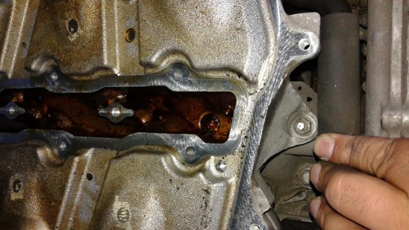

Indeed gary. As u can see. Its been almost a week or so. Ive went ahead today and open the intake manifold. I was able of course to remove the upper half. To remove the lower half was a pain. There were a nut infront of the manifold and another on the back side. These 2 nuts were actually driving me nuts. I attempted to remove but almost stripped it. So i stopped. Are these the nuts i need to remove for the lower part of the manifold?

We here on the forum have heard horror stories of using non-OEM fluid. The Matic fluid has some unique additives others may not. I wouldn't recommend saving a few bucks on the transmission fluid change, but it is up to you.
Not sure the bolt, but http://www.nicoclub.com/FSM/G35/". Not sure if that worked...
