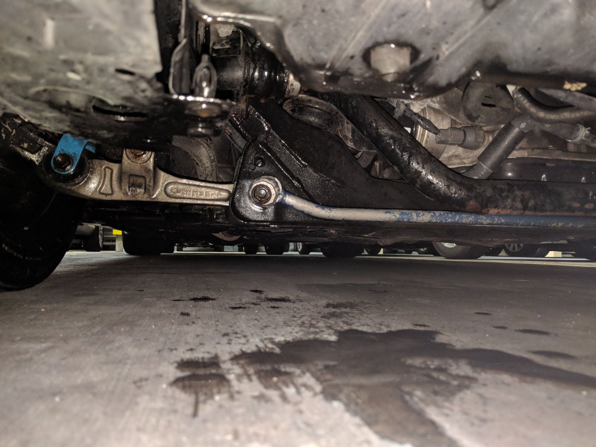

Quick question. I just went out to grab some Taco Bell and noticed my temperature gauge started to raise slightly. Not super crazy - but the thickness of a dime - compared to the needle staying dead center. Having said that, I took some pics and would like to piggyback some ideas that might be the problem; considering there's no coolant on the ground - but water. My thoughts are listed below as I'll follow up tomorrow:
(1) The level of coolant + water isn't properly measured. Thus, I have more water than coolant - that could've resulted in a blockage OR a cracked hose seeing how it got cold recently here in Maryland this Thanksgiving Weekend. [DIY]
(2) My thermostat is going bad and needs to be replaced. Thus, I need to replace my thermostat. [DIY]
(3) My water pump is going bad and needs to be replaced. Thus, I need to replace my water pump. [DIY]
Again, I'm not looking for troll comments as I just want to see what you all think [visually] after seeing my uploaded pics.
Water vs. Coolant right?
I say it water since it's clear
Spray over so I'm guessing busted line?

Alright so here's a new update. All of the hoses check out fine. There's coolant in the reservoir. However, I noticed [after wiping away most of the spray over near the radiator] the leak seems to drip from the seam of the radiator.
For example, where the plastic piece and the metal meet, and also at the bottom of the radiator seam of the radiator. Moreover, is after I let the engine idle for several minutes - to see where the leak(s) might be located, I noticed [in my cabin] the engine acted a little funny as if the idle-sound changed. Thus, I immediately shut the engine off, confirmed the radiator seems are leaking, and then came back 45 minutes later and noticed water spots under my exhaust tips.

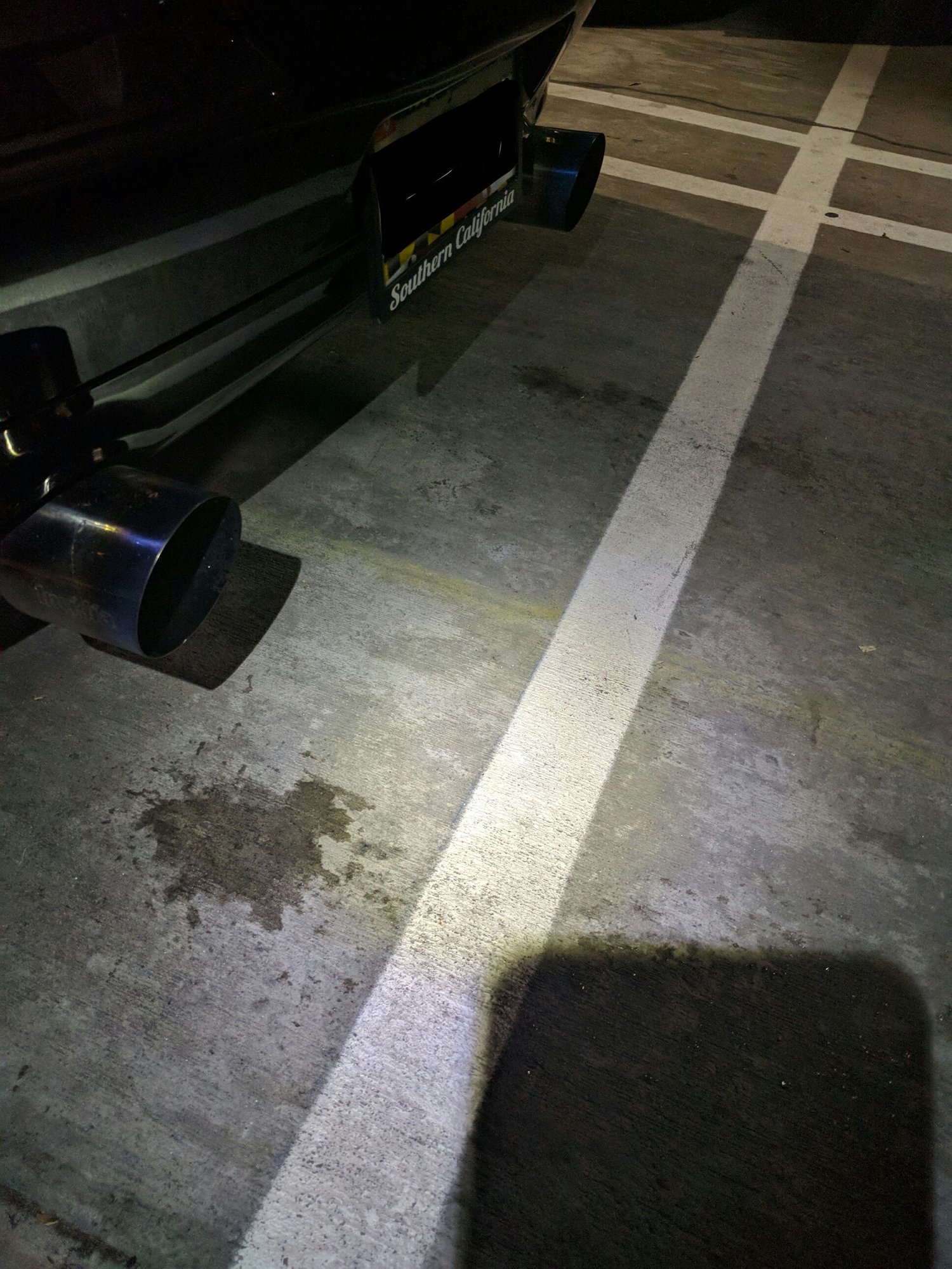

Having said that, now what else could be the issue - since water spots we're under my exhaust? BTW the weather tonight in my underground garage is 32°.
Leaking from top of the seem right?
Rarely do I ever check this but this doesn't seem right as that looks like a collection of liquid. Right?
Right under that hose is when the leaky-brown liqud started to leak from before I checked other seams of the radiator.
Drip puddles after returning back to my car to confirm the leaks we're by the seams. Mind you, I've seen this 3 months ago ONE time, and ignored it - hoping it was due to the cold weather. I'm just hoping it's not my gaskets that's are blown - as the car starts fine; there's no steam from the engine, and yeah . Thoughts?

The water under the exhaust tips is likely just condensation and is completely normal! You'd see an abundance of white smoke if it was a head gasket.
Regarding the leaks, I couldn't really tell where exactly on the radiator I was looking at based on those pictures, but it sounds like either one of the main hoses is leaking and you missed it during he pressure test, or the radiator itself is busted and you need to replace it. Obviously replacing the hose is preferable to the entire radiator, but both things likely need doing at some point as cars get older anyway.
I'd re-check the hose and clamp at that "seam" and probably replace them first to see if that fixes it. If not, then I'd go for the radiator. While you have the coolant drained, it certainly wouldn't hurt to swap your thermostat and put that hose kit to use!

I forgot to add this in my last post, but I'm also a little concerned that the leaking substance is brown. If that's what your coolant looks like, you are in need of a drain and flush ASAP! You should also double check you're not leaking transmission fluid, as that gets run through the radiator for cooling as well and may look brownish if it hasn't been changed in a while.

BRIEF UPDATE:
LEAKING TRANSMISSION FLUID: That's a negative.
POO POO BROWN WATERY SUBSTANCE: That's a positive.
CONCLUSION: The radiator is leaking from the top seam; near the top hose; in a slow fashion. Thus, after researching and learning about seam leaks on Mustang Forums i've pinpointed the issue. The top seam around the edge of the radiator is leaking and causing it to drip down onto both the bottom seams of my radiator; including, onto other areas of my engine bay...because it's not holding pressure.

So it's the rad or upper hose? Spray a leak finder powder and go drive around. It should show it's face quick.
