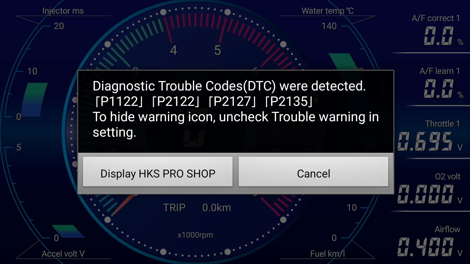

p2135 was the main error code I was receiving but sometimes I would get a few extras. The ecu reset code cleared these ok.
There were no real visible clues on the live diagnostics app i was using.

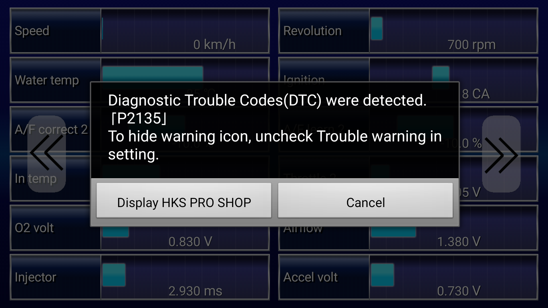

Screenshots from HSK OB-LINK - links to my android phone via the app, easy way to get real-time error codes.
