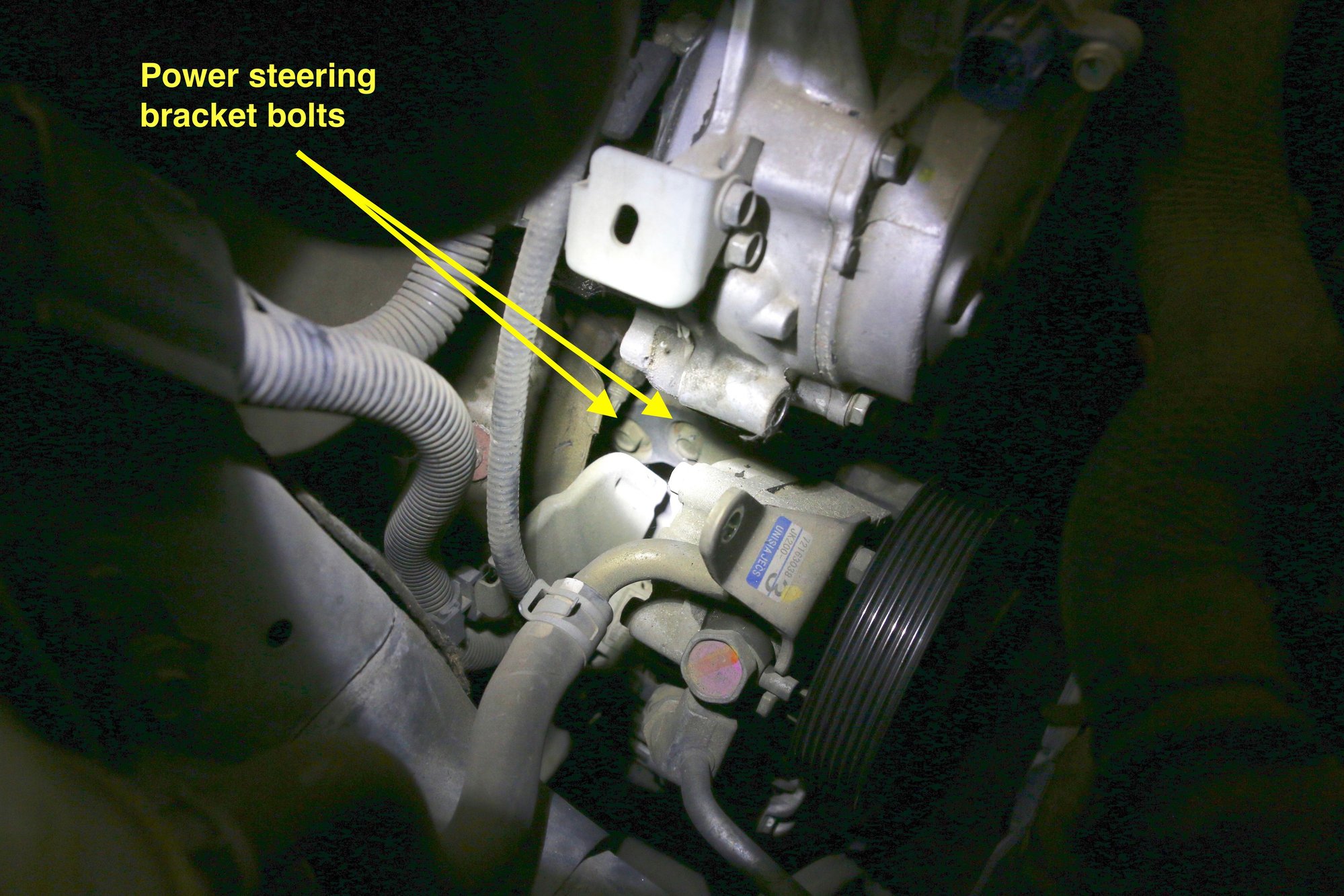

Ok I've got a replacement magnetic retarder in hand. I've removed the 2 pulleys and the bolts holding the power steering pump.
The big problem now is how to remove the power steering bracket. There are two bolts on the side that are super difficult to get to. I have rotated the power steering pump out of the way (slightly) but there is a heat shield and a bracket in the way.
How did you get those 2 bolts out? What tools did you use?

Ok answering my own question - the bracket that was in the way is held by two small bolts on the back of the alternator. I had to go under the car to get to them. Once the bracket was loose, I was able to remove the right bolt.
I am unable to budge the left bolt as the ratchet (and breaker bar) - have no room to swing at all. This is all that is keeping me from removing the VTC cover. What a pain....

Finally figured it out. Loosen the left power steering pump bolt (through the pulley opening). Then swing the pump left and down, tighten the same bolt to hold it in place and then use a swivel head ratchet.
The replacement of the magnetic retarder took 30 minutes using the directions provided in this thread. Put it all back together and drove for several days. No codes! Passed inspection easily.
Thanks to this forum and the posters for all the help. I could not have done it otherwise.
