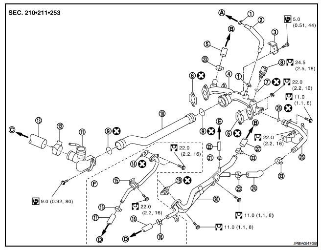

The leak is located at the other end of this hose where the clamp is located. Does anyone know where this leads too and the best way to replaced it?

Looks like part 24, if it's leaking from the front of the hose like the clamp just isn't tight enough then use a pair of angle head needle nose pliers to move the existing clamp further down onto the hose (past the metal nipple/barb that it's hooked onto) then put a worm drive screw clamp on instead. If you unscrew a worm drive clamp all the way it comes apart so you can fit it over an existing hose.
Thanks for the diagram! Yeah unfortunately the leak is at the other end of the hose so it's pretty difficult to reach the clamp. I was barely able to get an inspection mirror there through the crevices. I'm not sure if I'll have to remove several other things to clear some room.
