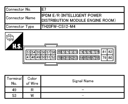

You want the IPDM one off the ECM relay, white wire, pin 53.

Here's a picture of the IPDM harness.

Most people just trace that white wire in the coil pack harness up a little ways past where they all join (factory splices off to each coil pack) then snip it there. It's a lot easier than taking the IPDM out but either would work.
