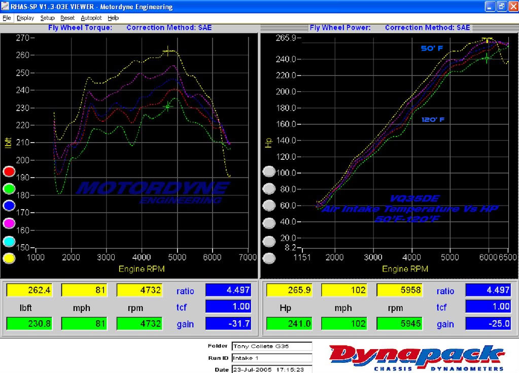

If its a code for the A/F sensor, its upstream of the ART pipes. This suggests either the sensor is bad or its not getting enough fuel.
A while back when I did Air Intake Temperature Vs HP testing, I noticed the engine runs leaner at low temperatures than it does at 80'F.
It also runs significantly richer at high inlet temperatures.
I'm not really sure if inlet temperature has anything to do with the code but the ART pipes shouldn't affect the A/F sensor either. The ART pipes are monitored by the downstream O2 sensor.
