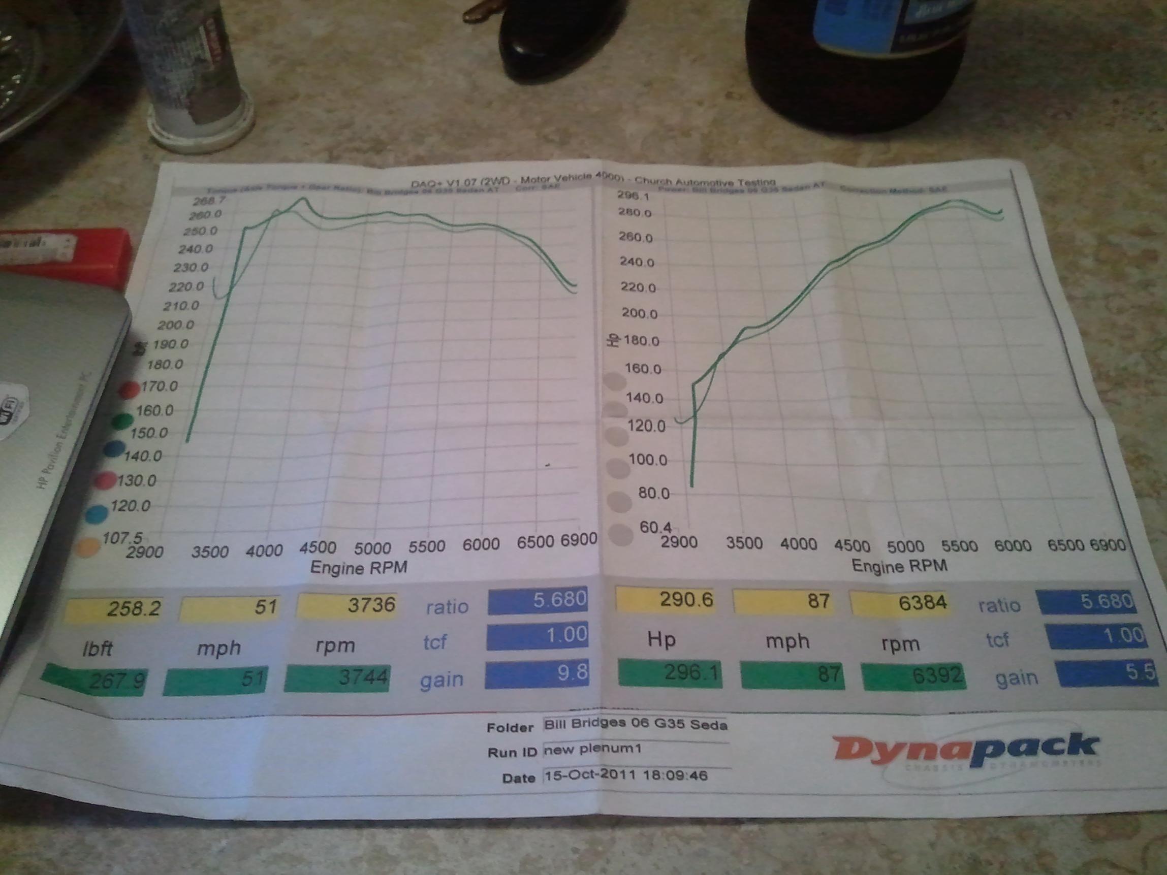

results
Attached Thumbnails Ported & Polished Intake manifold-2011-10-19-18.40.35.jpg

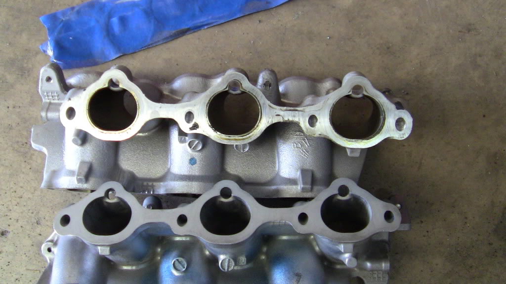

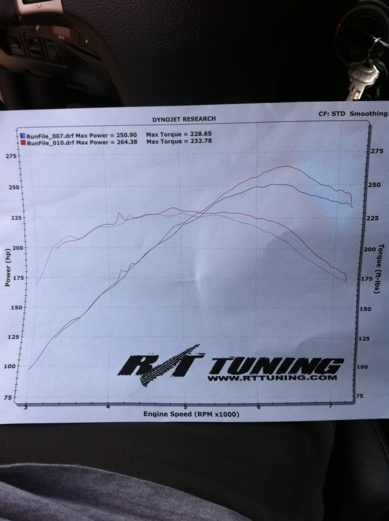

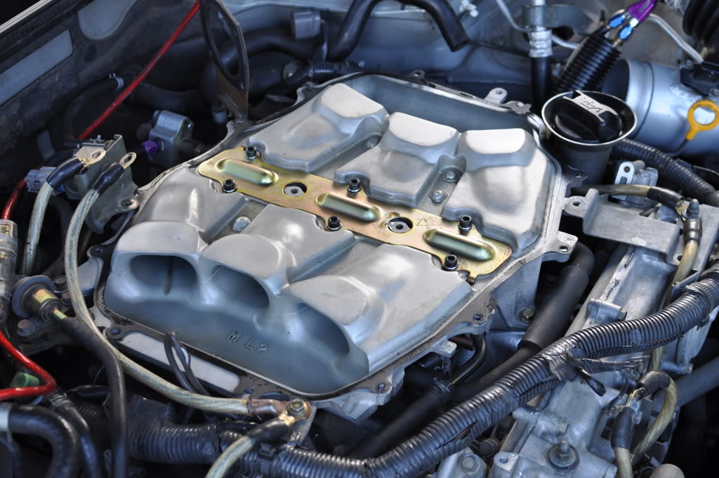

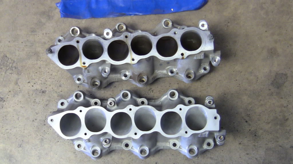

nice!! Here are a couple of pics of my ported plenum. I'm 5AT also I think more power will be found when you add the lower collector. info on mine I used the stock top instead of the big one. https://g35driver.com/forums/intake-...-manifold.html
What size spacer I used the MD 1/2.
The before was with a 5/16 and stock non-revup plenum 'I ran my 13.147 on that tune.

I'm runnin gthe 5/8 MD spacer , r u tuned? did you do the lower plenum and the runners at the same time?

I'm tuned my tuner didn't have to tweak my original tune much when the plenum was added. I did both at the same time.
