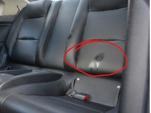

Their pictures are incredibly POOR which makes me think they're trying to hide the fact it doesn't have those options. It looks like a 6MT (automatically has the sport suspension/VLSD/19" wheels with the 6MT) with the sunroof as the only option.
If it DOES have the premium package and it DOES have RAS (turn ignition ON look for the RAS light to illuminate on the dash) then it would definitely be worth $10k at a used dealership with that mileage.
My biggest concern is that it's on the stock clutch, if so you might get a year or two out of it before it slips. See if it has a service history, also this is the rev-up engine which is a notorious oil drinker so you MUST check the oil weekly and top it off.
As for what you can actually tell from the shitty pictures, it has a ripped driver seat, and it looks like a cat may have pissed in the back seat you can see a big drip mark that is probably cat ****.

And I know it sounds wierd but sniff every seat, on a cool day the smell of years-old feces or urine will not be detectable until you're nose is inches from the seat but I guarantee on the first hot sunny day the whole cabin will smell like baby diapers. Fortunately cat **** is so pungent you can't hide it.
Some peoples babies DESTROY the back seat of the car, I've spawned two of my own and never had a problem but some people don't change those diapers frequently and it leaks out the edges, through the car seat, and pools in the base of the leather.
