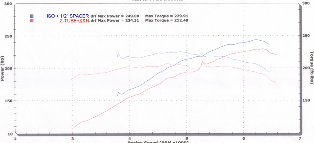

I had the MD ½” spacer+ Iso Thermal kit (Aramid gasket and CCV), installed on my 2003 5AT G35C. I disconnected the negative battery cable and pumped the brake pedal to reset the ECU. It’s a 50+ mile drive to the dyno, made sure I showed the ECU I meant business that day.
Found out I could break the tires loose in 1st and 2nd, SLIP light flashing. I was shocked how much faster the G felt throughout the entire RPM range.
I ran the AC, as Hydrazine suggested, for the last 10 minutes of the drive and shop turned it off once it was on the dyno. The dyno shows I gained 15HP and 17 FT-LB. The gain was throughout the entire RPM range. I personally feel this is one of the most powerful mods for a NA motor. Also the biggest bang for the buck
Before
Invidia G200, Z-tube+K&N
234.31 HP 212.49 FT-LB
After
Invidia G200, Z-tube+K&N, MD ½” spacer with Iso Kit
249.00 HP 229.91 FT-LB
I was able to recover the torque I lost, plus add 8 FT-LB. Next plan is to add an X-pipe to my Invidia G200. I’m hoping to add another 4 to 5 FT-LB through out the torque curve.

I could definately feel the difference with the 1/2 iso kit as well! Great Mod!

WHOA... nice gains man!!!
wassup with running the AC for 10 min. before the dyno though? whats the reasoning behind this?
*edit*
nevermind about the AC, i just read your other post, interesting, i'm going to have to try this myself
