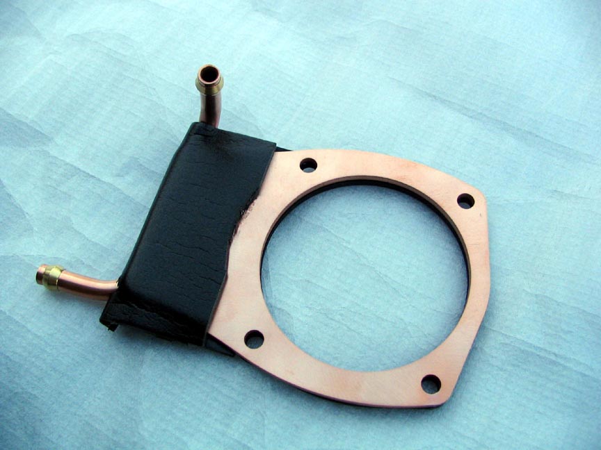

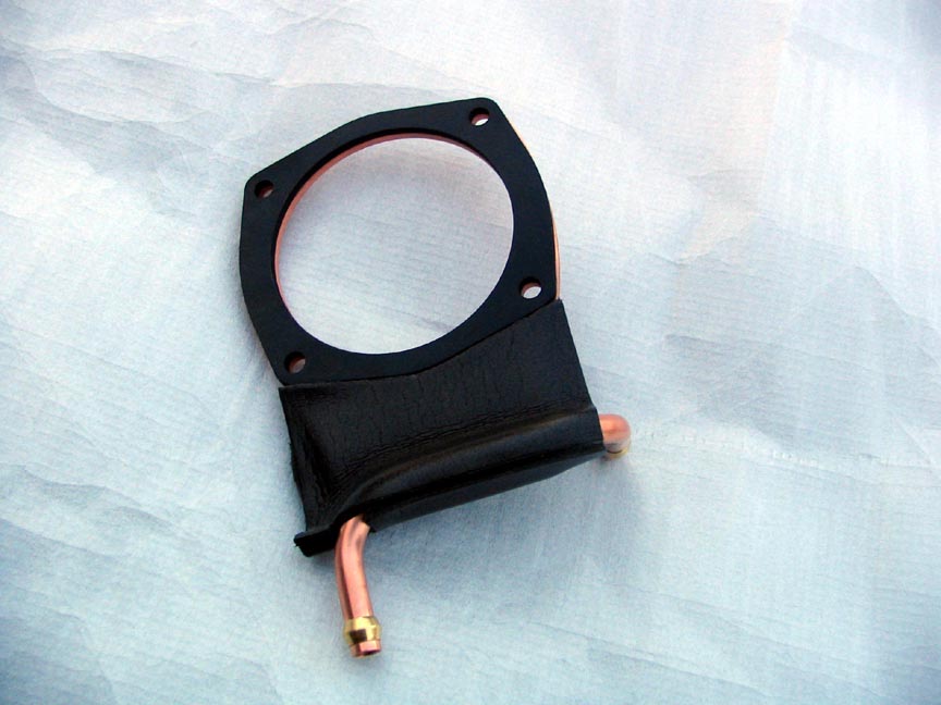

I looked at the Copper TB Heater, and wondered how much our occasional dips to -15 F to -30 F temps would affect the heating of the throttle body. To be safe, I decided to insulate most of the exposed surface of the Heater with an insulating foam tape (thoughtfully supplied by my neighbour in the Insulating business )
Not sure if it was necessary or not, but I thought I may as well.
