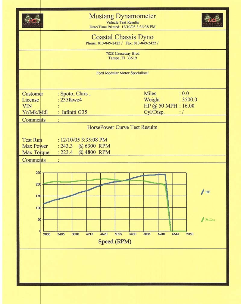

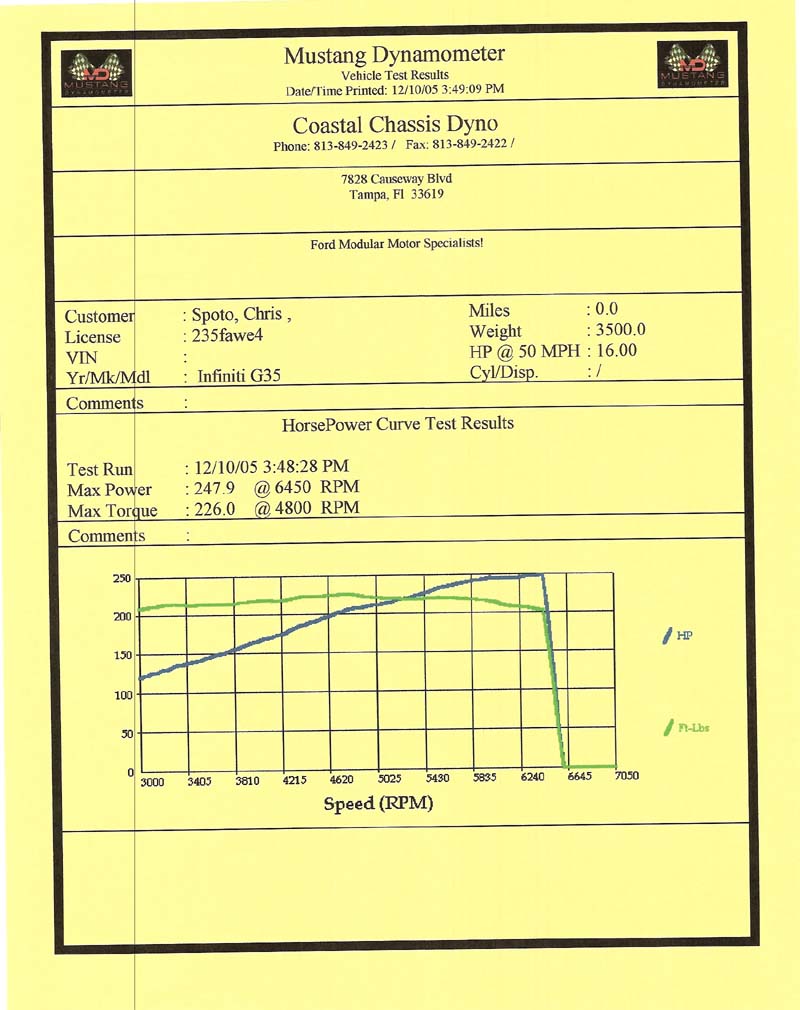

05 G35 6MT dyno
Got my car dyno'd today. Mods I have are ztube + stillen cai + MREV. It was done on a mustang dyno in 3rd gear - do mustang's dyno lower than other ones?
Yes, Mustang dynos read lower because they do compensate for more things than dynojets or dynapacks. But that makes it arguably better for tuning... Is that a before and after or just the two best pulls?

2 pulls 10 mins apart , lower # was first pull

i've been reading mustangs are 6-8% lower than dynojets, that might be overly optimistic but it would put me @ 260-265hp/ 230-235ft lb ?

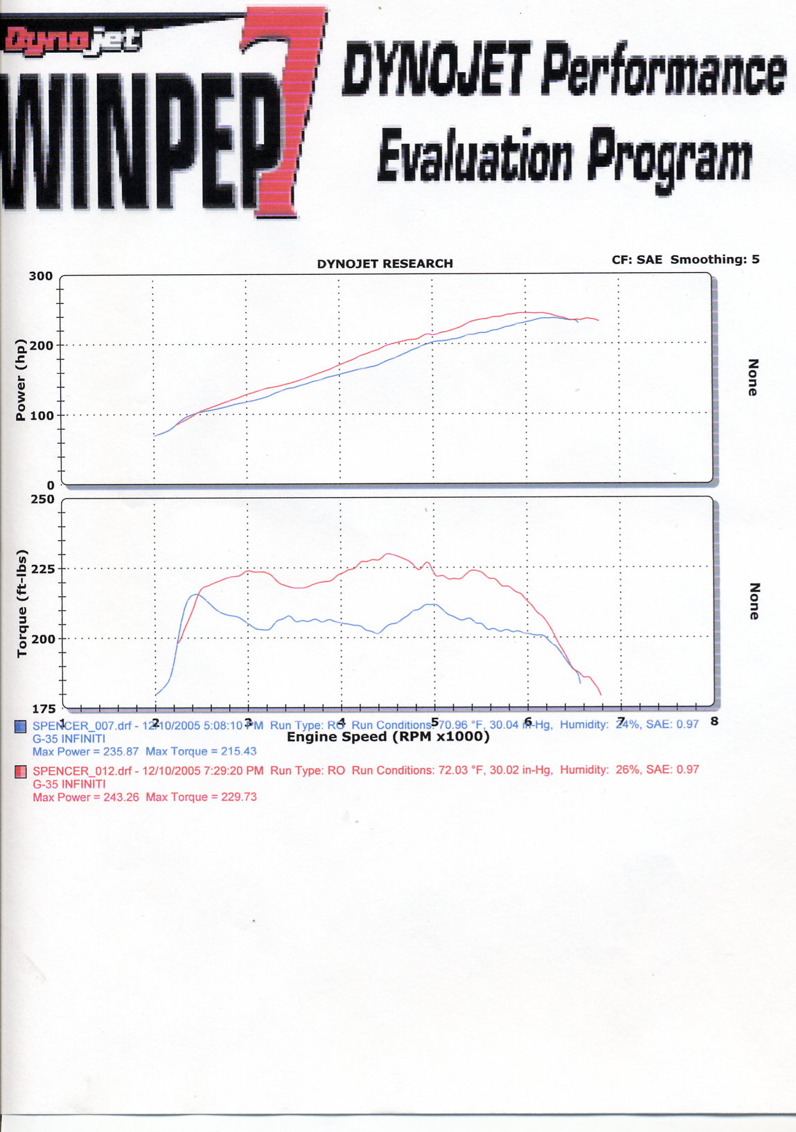

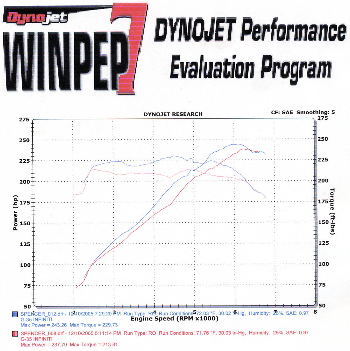

Mine was done on a dynojet in 4th gear on a 6mt sedan. The runs are before and after I installed the mrev plus with the iso thermal valve closed. I graphed my best baseline run and my best modified run. Oh, I dyno'd with the stillen intake and z-tube before and after. There is a huge incease in torque around 4500 rpm. Truthfully, I can't feel that much of a difference, but it is definitly there according to the dyno anyways.
https://g35driver.com/forums/images/attach/jpg.gif
Attached Thumbnails Motordyne MREV Mod-mrev-dyno.jpg   Motordyne MREV Mod-mrev-dyno-2.jpg
