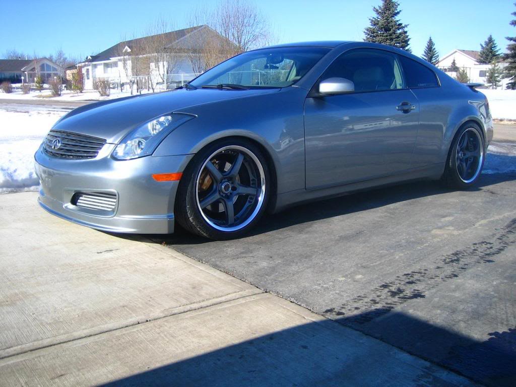

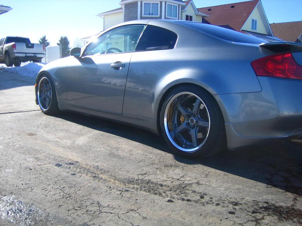

This is my old set up 10.5+17 rolled no pull -2.5 camber with 285/35 so your original set up would stick out 5mm more.with a 15mm spacer that is 20mm more but 265mm tires brings you to about 15mm more than mine that is pictured so a pull and camber will give you enough room.
