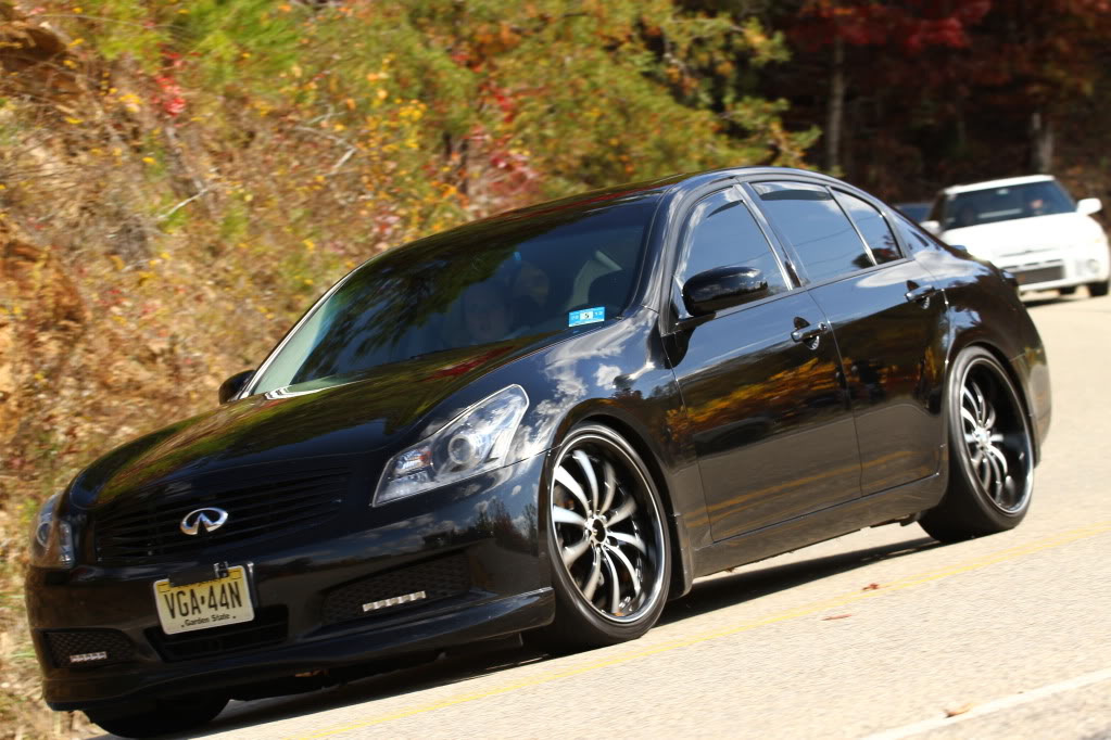

i have 2008 g35 staggerd set up.i got lexani the rear is 10.0 width i was running 275/30/20 and from was 8.5 width 245/35/20.im looking for a nice stance.should i go to a 285 tire or stay at 275 and should i go wider in the front..im looking to order some tires in a day or 2 thank.here is my set up now.Name:  img_9366.jpg

Yea you could probably do the 255/35 285/30 combo.
To set off the aggressive tires though, should considering running some small spacers and get the wheels right to the fenders!
