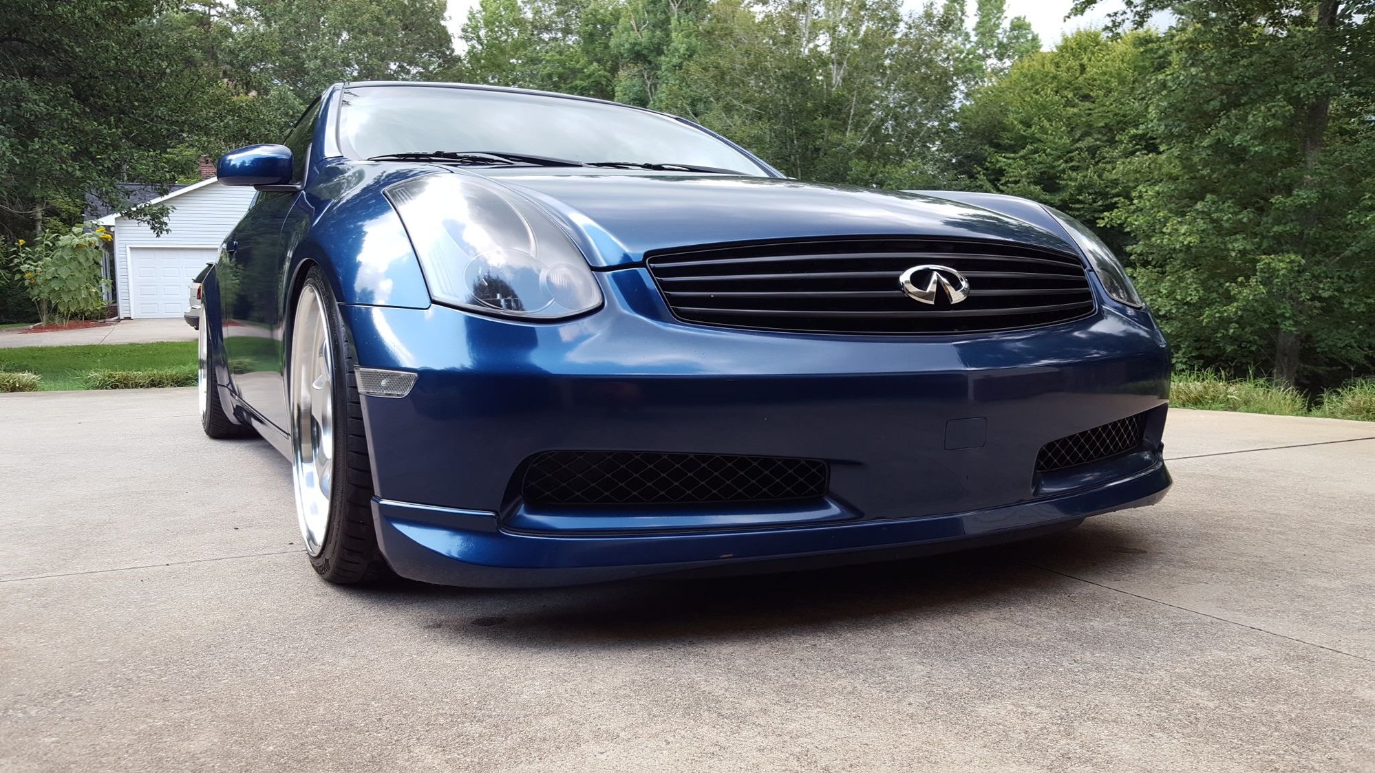

Originally Posted by Haridasa
This front bumper.
Wait, that's Shane's G, but I thought he had a NISMO bumper too. Has that always been Shane's bumper? Lol

I don't know currently but he HAD a NISMO at one point:
Attachment 187939
Attachment 187939
Damn, those te37s look good. I really wish they would have done the LMGT4 in 19s with the concave of the 18s and te37. The LMGT4 18s are basically a 5-spoke te37, but I like the 5-spoke better. The 19" LMGT4 are all flat faced and ugly. I want a damn 19" concaved LMGT4 damnit! Haha
